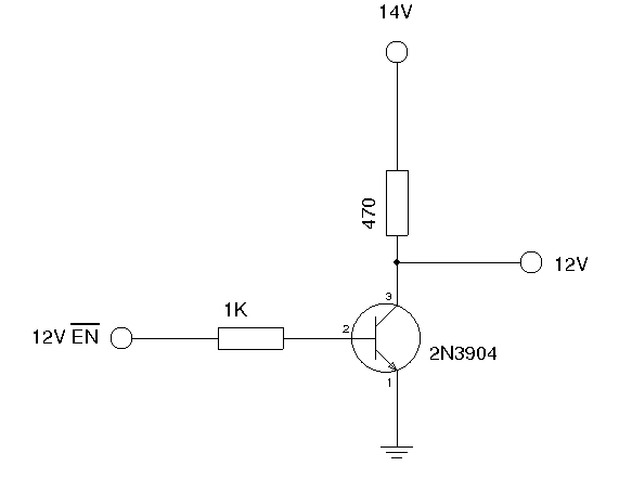

For the high voltage programming enable 12V supply, I chose to use a simply transistor switch instead of the boost converter:
![12V Supply 12V Supply](http://www.kerrywong.com/blog/wp-content/uploads/2010/06/HVEnable-300x232.png)
The drawback of this approach is that the output voltage is not as precise and I had to experiment a little bit to obtain the required HV programming voltage The enable signal comes from the Arduino is around 4.5 V which may not be sufficient to put the transistor in the saturated mode and in my case with a 14 Volt supply, I was able to obtain the required 12 V output. Since the control signal is inverted compared to the original schematic in the article, I had to invert all the digitalWrites to the 12V enable pin to make the program work with my version of the shield.
