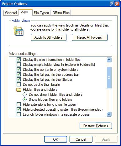

Microsoft Outlook Express: Before you do the backup, you need to make sure that you turn on "view hidden files" in your file explore options. (Tools->Folder Options, and choose Show hidden files and folders) See below (shown for XP, for other systems the actual image is slightly different):
