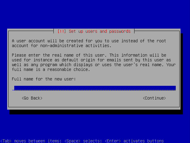

For a dedicated server, the default partitioning scheme (use entire disk) should be suffice.
If you are setting it up on your home computer, this is usually blank.

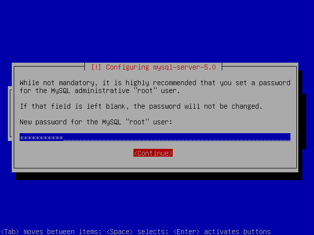

For the WordPress server setup LAMP and OpenSSH are the only required components. However, I usually add the Print Server (CUPS) so that the whole home network can share the printer on the WordPress server (since it is always on) and Samba File Server so that I can copy files from a Windows machine.
Don’t confuse MySQL root user password with the Ubuntu login password. They can be the same but it is recommended that you use a different strong password for each.

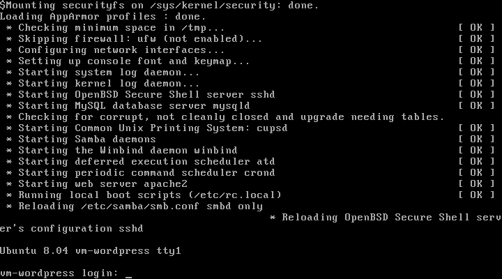

If everything goes well, you should be greeted with this login screen after your machine is re-booted.
