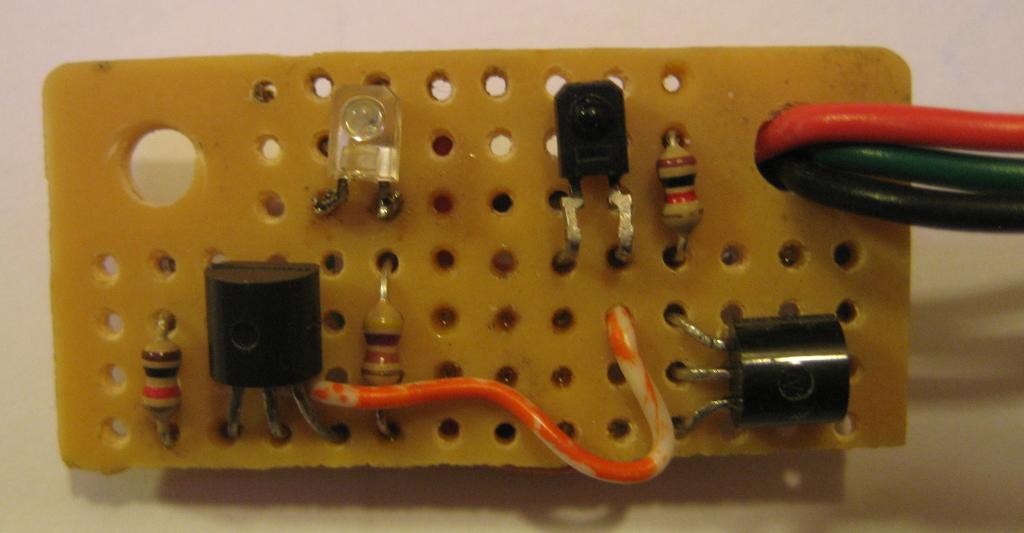

Here is the completed circuit board. A divider between the IR diode and the IR photo-transistor may be needed to reduce the interference.

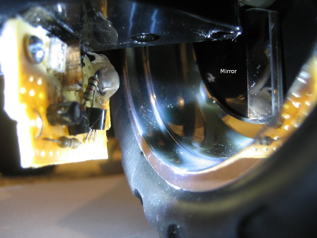

The following picture shows the circuit board mounted on the underside of a toy car. I used a narrow strip of mirror as reflector to work with the optical detector.
Encoder Mounted on a Model Vehicle
Since I only used one mirror, this configuration can only send out one pulse per rotation. To improve the output resolution, you can construct a more sophisticated reflector pattern.
