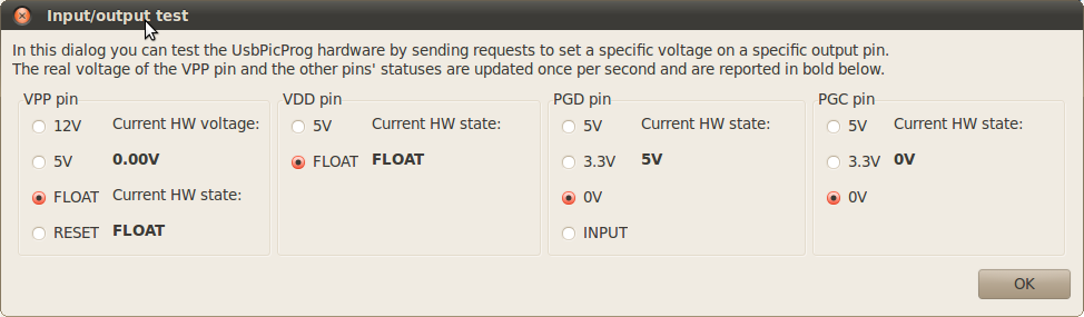

USBPICProg provides a few input/output tests that you can use in conjunction with your hardware to make sure that the programmer is working as designed. For instnace, when first plugged into the USB port, the states of VPP pin, VDD pin, PGD pin and PGC pin should be as follows:
Control Pin States (Default)
And by clicking each radio button, you should see the HW states change. Particularly, the VPP pin should change to the voltage selected as seen below:
Verifying Programming Voltage
