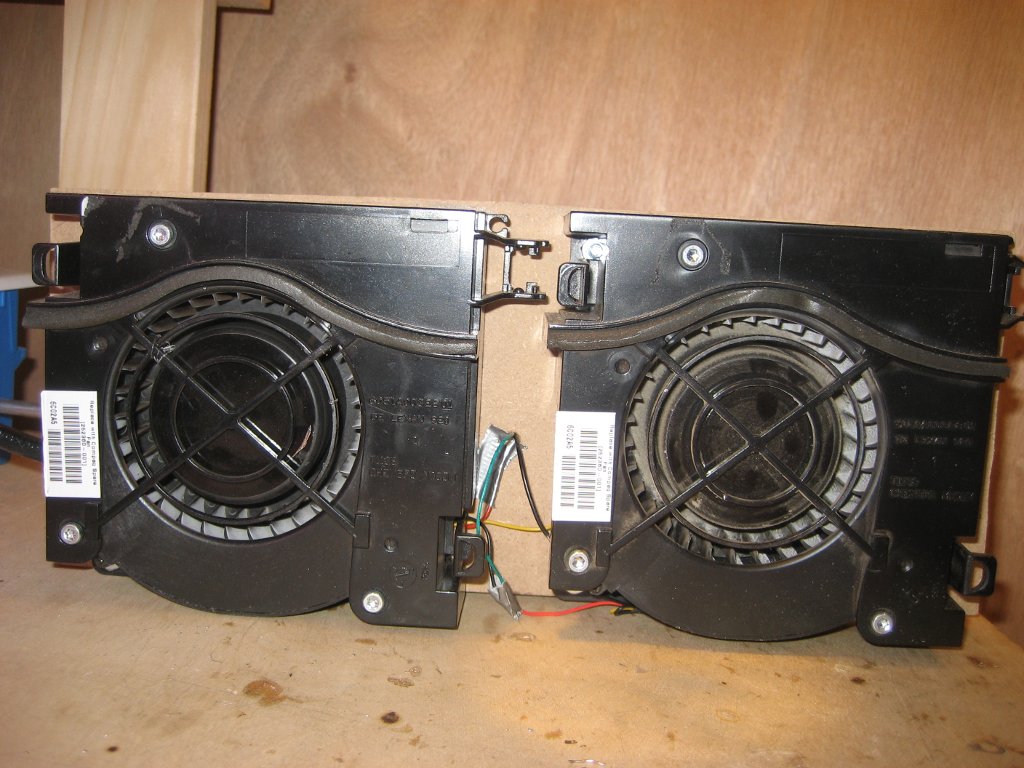

So I experimented with a few different methods and found that using server blower fans achieved the best results.

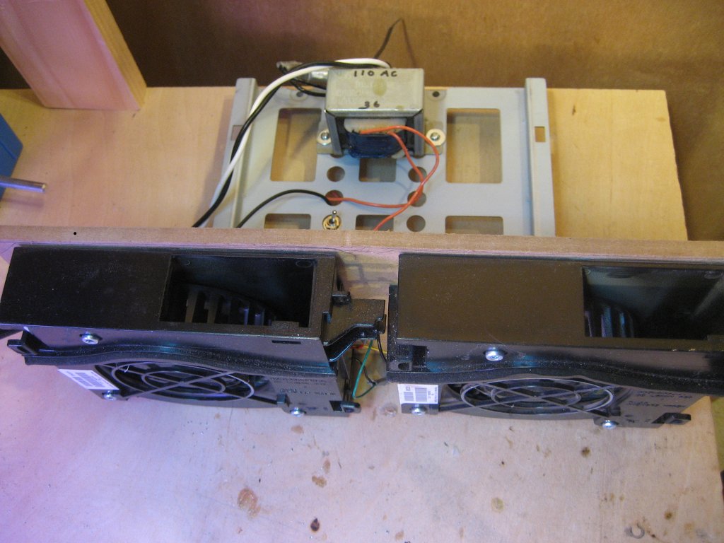

The following is my version of the fume extractor using two 10cm 24V server blower fans.
When powered at the rated voltage (24V), the created suction is effective at least within 2 to 3 feet. This should cover enough area for your soldering work.
A draw back is that this kind of blower fans are very noisy. But they can be operated at lower voltage to reduce the noise (and thus the air flow). You can easily control the air flow with a TRIAC dimmer circuit or using a variable power supply for the blowers.
