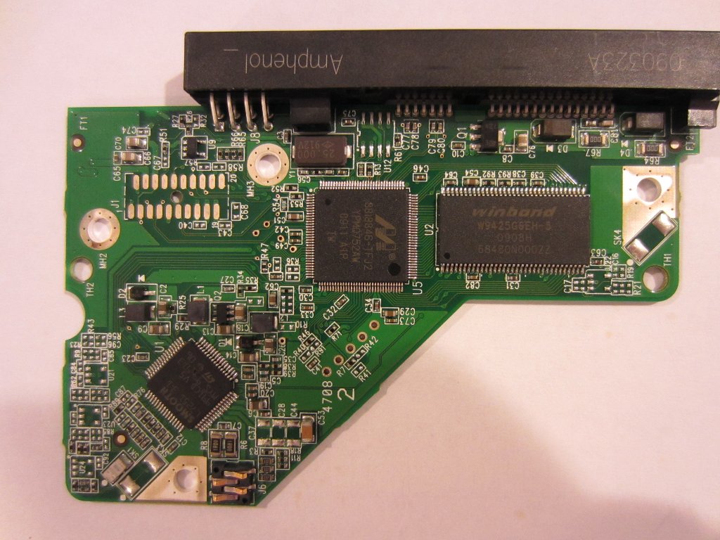

I pulled the dead drive out from the PC and unmounted the PCB. At first it appeared that everything looked normal (see picture below). The +12V and +5V pins on the SATA connector does not appear to have been shorted to the ground (there are protection TVS diodes on the power rails, in an over voltage event they are likely to be the first ones damaged. This usually manifests as a shorted power rail). But after some careful examination, the spindle motor driver chip marked as SMOOTH L2751 3.1 seemed to have suffered some thermal damage.

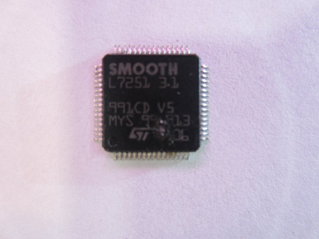

There was a tiny burned mark towards the lower right of the chip. It didn’t show up well in this picture, but you can see the damage clearly in the picture taken below after the chip was removed.

With no other signs of physical damage, I decided to take my chance by swapping out the spindle controller chip. Unfortunately there is not much information on the Internet about this particular chip, which is not surprising as these controller chips are aimed at highly specialized markets and are not designed for the typical consumers. The closest match I could find any information on is for ST’s L7250, presumably L7250 and L7251 are very closely related in terms of design and performance.
Sourcing L7251 V3.1 turned out to be another challenge. I could not find this chip anywhere in the US from any of the major component distributors. Eventually I ordered a couple from Aliexpress. After a few of weeks’ waiting, my order eventually arrived and the chips looked to be identical to the failed controller chip pictured earlier, the only differences appeared to be on the date codes and serial numbers.
![New Controller Chip](http://www.kerrywong.com/blog/wp-content/uploads/2012/12/newcontrollerchip-300x225.jpg)
Encouraged, I soldered the replacement chip onto the controller board using my hot air rework station. And to my great surprise the replacement chip actually worked right off the bat! The harddrive came back to life after I mounted the circuit board back on. Better yet, everything on the harddrive remains intact! To be honest, I didn’t expect it to be this easy (in general Murphy always wins).
