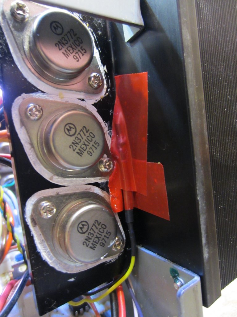

Here are a couple of pictures showing the placement of the thermistors.
I am quite pleased with the result of this simple hack. Now my Topward 6603A is silent most of the time and the fans only come on briefly every so often when the power dissipation is high enough.
