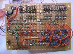

In this schematic, IC5 and IC6 are two 74HC138 3-8 line decoders, they are chained together to generate the strobe signal needed for driving the gate. a couple of 74HC04 inverter chips are used to invert the outputs from 74HC138’s so that the input sequence to the 3-8 line decoders corresponds directly to the grid that is being driven high. Of course, the inverters are not strictly necessary as you could easily invert the control signals in software.
IC7 and IC8 are two 74HC595 shift registers, their outputs are used to drive the nine segments (i.e. a-g, comma and decimal point).
The TTL outputs from IC5-IC8 are translated to higher driving voltages required by the VFD via four ULN2003A darlington driver chips. The output signals from the ULN2003A’s are then inverted by the PNP transistors (all of which are 2N3906). Each PNP transistor controls a control grid or a display segment. Technically speaking, using ULN2003A is a bit of an overkill as the load current is negligible in this case. You could easily achieve the same result by replacing the darlington driver chips with individual NPN transistors such as 2N3904. But using ULN2003A does simplify the circuit a little bit as the base resistors are included on the chip.
Because the current requirement for driving the gates and segments is very low for vacuum fluorescent displays, we can use relatively large load and base resistors. The values of these resistors are not critical and can range from 100K to 1M. Typically, we want to choose larger resistors to limit current consumption. But on the flip side, large resistance value does have some negative impact on signal transition time (e.g. rise time) due to the effect of the large RC constants formed with respect to the BJT junction capacitance. When the refresh rate is relatively low (50Hz to 100Hz), this RC constant has little effect on the quality of the driving signal. But as the refresh rate increases, the RC constant’s effect on the signal slew rate will become more pronounced and causing noticeable ghosting effect. Of course, this issue can be easily addressed by using a complementary output stage, but the resulting circuit will become much more complex and you may as well just use a dedicated driver chip at that point.
Here are a couple of pictures of the driver circuit I built on a perfboard:
