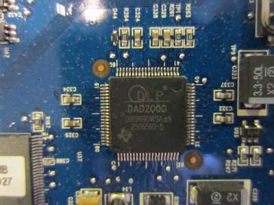

There are a couple of TI‘s DLP proprietary chips (possibly CPLD or FPGA).
UF55_14 UF55_15
