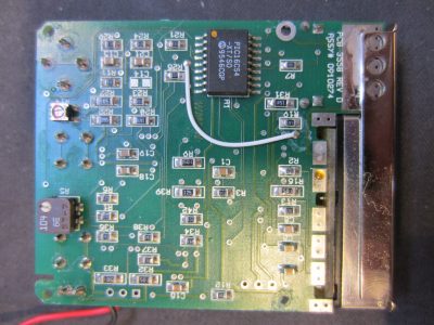

After removing the back cover, we can see the back side of the circuit board. The main chip used in this fieldmeter is a Microchip PIC16C54 8-bit microcontroller. The datecode suggests that this unit was made sometime after 1995.
Fieldmeter_3 Fieldmeter_6
