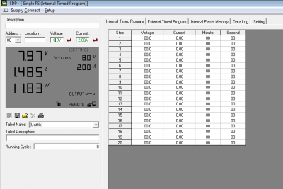

Once the logic analyzer is hooked up, I powered up the BK Precision 1696 using an isolation transformer and also connected the serial port to the computer so I could use BK Precision’s SDP software to control the power supply and obtaining the display data. This is extremely helpful as I would not otherwise be able to see what’s being displayed on the LCD at any given moment given the fact that the display was broken.

One of the more challenging aspect of protocol reverse engineering is to make sense of the data, and for that we will need a clear strategy. To make the reverse engineering a bit easier, I first disabled the output and using the SDP software to increment the output voltage 100mV per step and at the same time recorded the waveforms as Vset changed from 1.0V to 1.9V. While adjusting the set voltage, the set current is fixed at 1A so the only changes in the output should correspond to the set voltage and nothing else. And then I incremented the set voltage 1V at a time from 2 to 10V and recorded the waveforms again. Finally I captured the waveform when the set voltage is at the maximum (20V). Once I have identified the bytes that control the set voltage, I used similar technique and identified the bytes that is responsible for setting the current.
Once the bytes for controlling set voltage and set current display are identified, I went on and analyzed the bytes that are responsible for the actual output voltage and output current. Here is a screenshot showing a portion of the captured data. For those who are interested, the entire spreadsheet of the captured data can be downloaded here.
