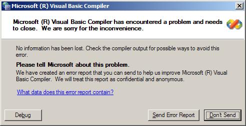

Sometimes, you will get this error when trying to compile the VB program:

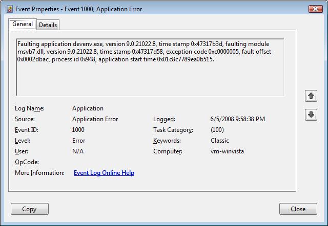

And here are the corresponding application events in event viewer (corresponding to the VB environment crash):

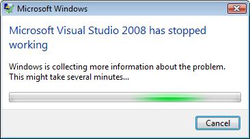

When trying to move to the end of the line, both VB and C# application would crash the IDE and give the following error:
And the Visual Studio 2008 IDE would then close.

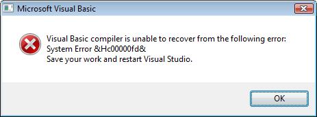

The same code in VB would not even load without giving the following error:
And if you close the error dialog and try to compile the VB.Net code, you get this error message:
Visual Basic compiler is unable to recover from the following error:
System Error &Hc00000fd&
Save your work and restart Visual Studio.

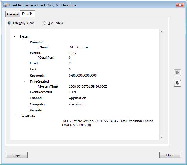

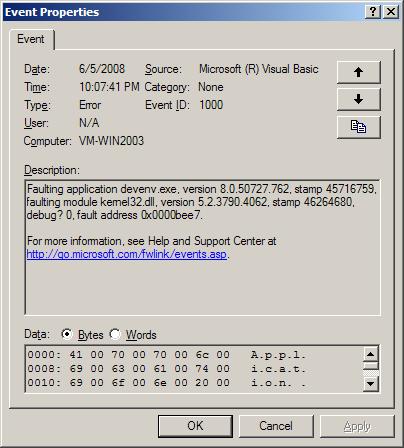

Which is the same error message as in Visual Studio 2008. And the event viewer records the following information:
The VB.Net environment’s crashes are more troublesome. As indicated by the event viewer, it seems that the the exception chain went all the way to the kernel32.dll (note, if you choose the debug option when the VS 2005/2008 environment crashes, you can actually see the full exception chain along the execution path).
