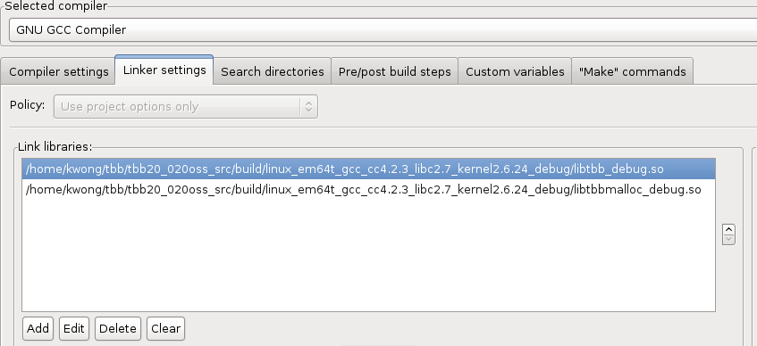

Start Code::Blocks, and choose File -> New -> Project and choose Console Application. Again, we will use the sub_string_finder.cpp sample code. The library path/include path properties can be set either at the Workspace level (one workspace can contain multiple projects and the settings are inherited unless overwritten) or project level. Assume that we are configuring at the workspace level. Click and highlight the workspace, and choose from menu Project -> Build Options and click on the Linker settings tab. Add the libraries to be linked here:
Note that only the first entry was necessary for this particular project. As you can see from above, you can configure multiple library dependencies here easily. Now click on the Search directories tab, and set up the include path:
