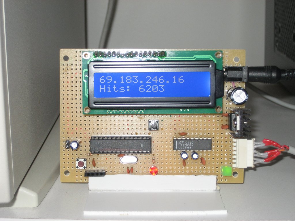

I wanted to be able to check my web server’s statistics periodically but did not want having to log on ever time when I wanted to do so. The simplest way to achieve this is to have the computer monitor on and run a server statistics program that outputs the information onto the screen. There are two issues associated with this approach however: the first problem is that a dedicated monitor will be needed which is not typical in a server configuration. And the second issue is that a monitor would waste considerably amount of power when powered on 24/7.
So I decided to build a low power consumption auxiliary display that would enable me to show some of the server statistics. The idea here is to use a microcontroller circuit that displays information sent from the server via a serial link. I used an ATmega328p mciro-controller and used Arduino library for the MCU programming.

To simplify the coding on the mciro-controller side, I padded each line to 16 characters (that’s the number of characters can be displayed on each line on the LCD). Also, the contents of the file (6 lines, 16 bytes each) are sent to the MCU all at once, it is up to the code at the MCU side to decide which lines to display. This way, we only need one-way serial communication (i.e. from computer to the MCU).

In the main loop, the MCU sits passively waiting for either serial port inputs or the push of a button (attached to pin 9). At the end of each one minute interval the server side code refreshes and the latest 96 bytes of data is sent over to the MCU via the serial port. The 96 bytes are parsed into 6 lines of data, 16 bytes each line, and stored into the messages buffer.
If the button attached to pin 9 is pressed, the counter opt is incremented and result modulo 3 (i.e. 0, 1, 2) is then used to choose which set of the lines to display (the 6 lines are divided into 3 sets since I am using a 16×2 LCD).
The three pictures below show this auxiliary display in action:
