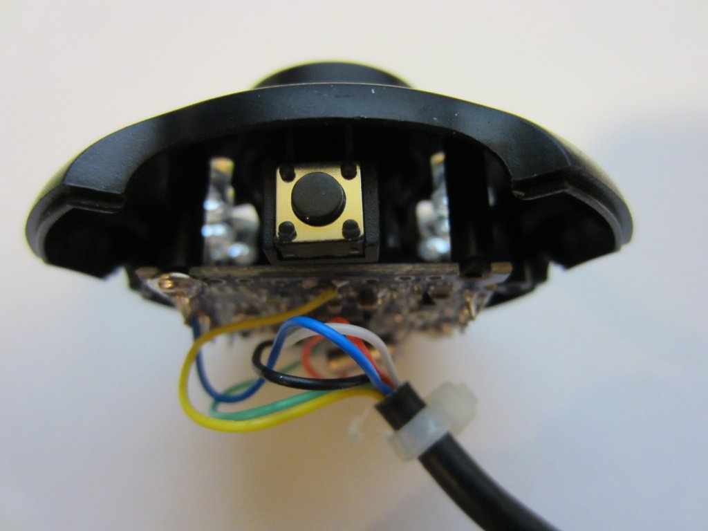

If you look at the picture above, you’d see that the tactile push-button located on the top seemed to be “loose”. Here is a picture of this push-button viewed from the top.
![Webcam 1 Webcam 1](http://www.kerrywong.com/blog/wp-content/uploads/2012/07/webcam1_int2-300x225.jpg)
The button itself does not seem to be connected to the main board in any obvious way. At first, I thought this was some clever design. But when I gently pulled the button, it slid out without any resistance. It is actually not connected!
![Webcam 1 Webcam 1](http://www.kerrywong.com/blog/wp-content/uploads/2012/07/webcam1_int3-300x225.jpg)
As you can see from the picture below, the space where the button is placed has no connection to other parts of the circuit at all. So the designer actually went into all these troubles to design a switch that does not work.
![Webcam 1 Webcam 1](http://www.kerrywong.com/blog/wp-content/uploads/2012/07/webcam1_int4-300x225.jpg)

As for the tactile push-button? Well, it used the same “design technique”, except that the person who assembled this webcam somehow installed the button backward and left the unclipped pin side out. You can see this from the picture above.
![Webcam 2 Webcam 2](http://www.kerrywong.com/blog/wp-content/uploads/2012/07/webcam2_int2-300x225.jpg)
Without the button, I would have already raved about the camera given the good image quality and extremely low price point. The designer must have felt inadequate not to include this clicky design and decided to fake it. But the reasoning behind this is truly mind boggling. After all, it is already a pretty good product why include something that is inoperative by design?
