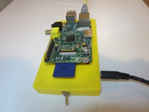

Fortunately, it is quite easy to add a barrel jack and an on/off switch to it. As you can see from the pictures below (the reverse side of the Raspberry Pi board), the +5V and Gnd connections from the micro USB port are routed to the polyfuse (+5V) and the zero ohm resistor (Gnd) respectively. So all that is needed is to wire the barrel jack in series with the power switch directly to these points.
One thing we need to pay attention to is that both the polyfuse and the zero ohm resistor should be connected in the current path as they provide overcurrent protection to the rest of the board. The correct connections are shown in the pictures above.
Once the wires are in place, I mounted the Pi board onto a plastic cover and then installed the barrel jack and the switch there. The pictures below show what the board looks like after the modification. Now the Raspberry Pi board can be powered by either micro USB or a standard 5V power jack.
