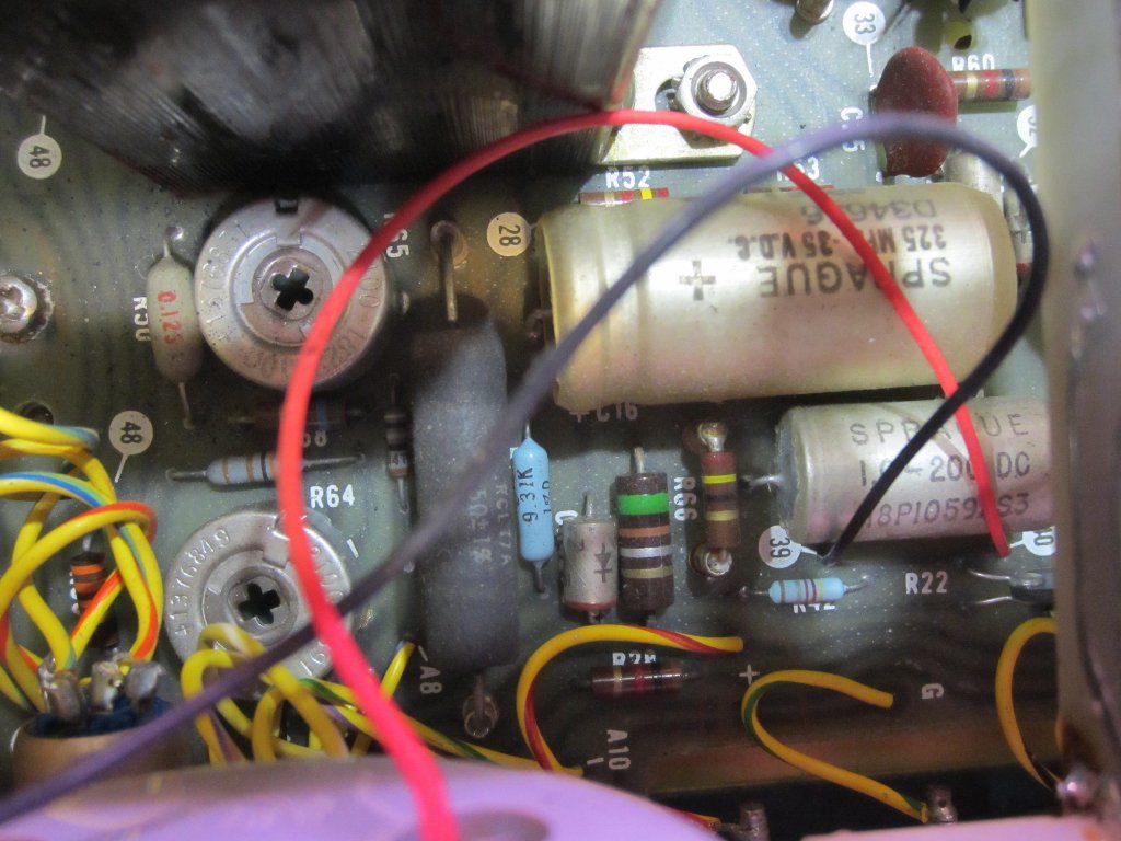

Because the specs are mostly guaranteed by the use of precision resistors, there are only very few adjustable components. In the left picture below, there are two large trim-pots which are used to adjust the panel meter full range in either voltage or current mode. They only affect the display accuracy and not the accuracy of the power supply itself.
The two red trim-pots (R14 and R16) on the right are the only ones affect the actual voltage and current setting values. R14 is used to calibrate the zero-crossing voltage (in current mode) and R16 is used to fine-tune the output voltage.
HP6113A_Cal1 HP6113A_Cal2

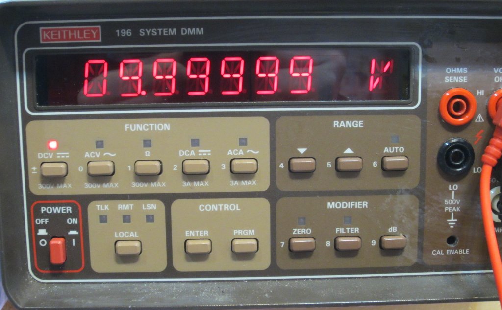

When I got the unit, it was still within spec according to my Keithley 196. It was probably last calibrated a couple decades ago but those precision resistors are very stable and rarely go out of tolerance. Since the resolution of Keithley 196 is 100 times better than 6113A, I thought I would re-calibrate the power supply so that it matches the meter readings. I carefully adjusted R16 with the supply set to 10V output until the meter reading was 10.00000V.
It is actually quite difficult to adjust the trim pot to get the the exact voltage reading because R16 only has a single turn. I may replace R16 with a ten-turn precision trimmer down the road. Anyway, this exercise was also to see how much this power supply drift over time. So after it was calibrated, I left the power supply on for a couple of hours and then measured again. The reading was 9.99999V, which was virtually unchanged. But this was somewhat to be expected from a precision voltage source in a climate controlled environment.
