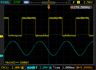

The pictures below were taken while testing MTD6501G. The PWM pin was also left unconnected. The four traces on the oscilloscope are from the frequency generator (pin 1) output and the three phases.
MTD6501G_1 MTD6501G
Here the waveforms from the frequency generator output and one of the phases are captured using a DSO. The picture on the left shows the PWM sine wave and the the picture to the right shows the filtered (digital low pass filter set to 500Hz) waveform.
MTD6501G MTD6501GFiltered
