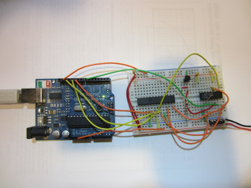

Here is a picture of the circuit built on a breadboard for testing purpose (AD8603 was not shown in this picture). Each chip is decoupled with a 100 nF capacitor.
ExtResDacSetup
The program below sets the DAC output voltage to 6.3V (corresponding to DAC inputs half way between 64 and 65). Because the digital potentiometer has an additional 8 bits of resolution, the minimum output voltage resolution (approximately 38 µV) is 1/256th of the DAC resolution (approximately 9.8 mV).
