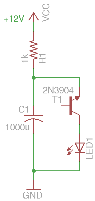

The circuit I used is a simple LED flasher, similar to what was described here. As with any circuit that exhibits negative differential resistance, the principle of operation is quite simple. The capacitor is charged via a current limiting resistor. When the voltage is low, the current that flows between the emitter and collector is roughly the reverse current of a diode which is negligible. When the voltage across the capacitor reaches a certain level, the transistor enters the avalanche breakdown mode. In its avalanche breakdown region, the transistor exhibits negative resistance (i.e. the higher the current, the lower the resistance) so the capacitor discharges rapidly through the LED and the voltage across drops until the avalanche mode can no longer be sustained. At such point, the transistor enters its normal operation mode and becomes non-conductive again. Thus the cycle continues. The rapid discharging through the LED manifests itself as short blinks. The blinking frequency largely depends upon the RC constant and the transistor breakdown characteristics.
Flasher
Depending on the LED you use, you may need to add a current limiting resistor to protect the LED during discharge. But for a typical 5mm white LED, no resistor is needed as the duration of the current flow is extremely short.
Using the RC values in the schematic above, I measured the minimum voltages required for the circuit to oscillate using different transistors and the results are listed below:

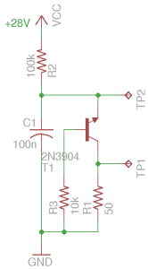

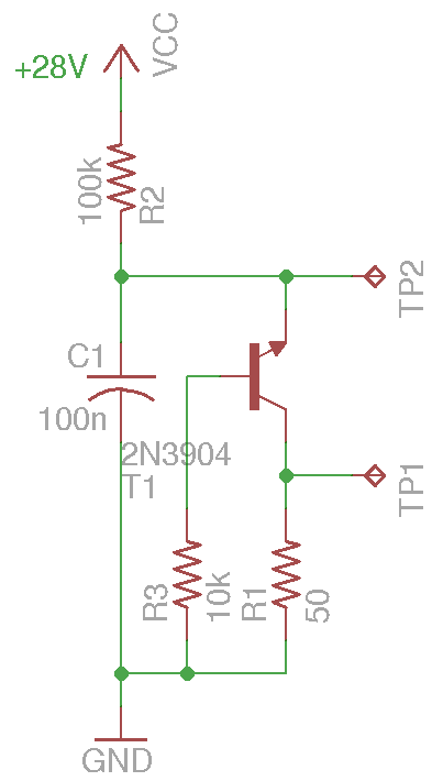

The circuit below shows my experiment setup:
pulser
One of the key differences in this circuit between a negistor pulser a standard avalanche pulser is that the capacitance cannot be arbitrarily small. In my case, 100nF seems to be near the lower limit. Also notice the based resistor (10K) used to reverse bias the base-collector junction. Like in standard avalanche pulser the inclusion of the base resistor increases the avalanche breakdown threshold voltage which translates into higher avalanche current and shorter rise time.

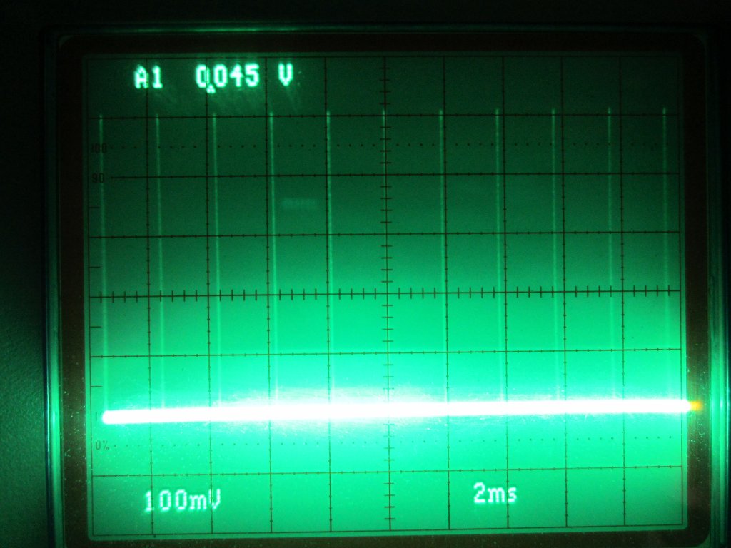

The oscilloscope capture below shows the waveform measured at the collector (TP1). The pulses are repeated at roughly 500Hz when the supply voltage is around 28V.

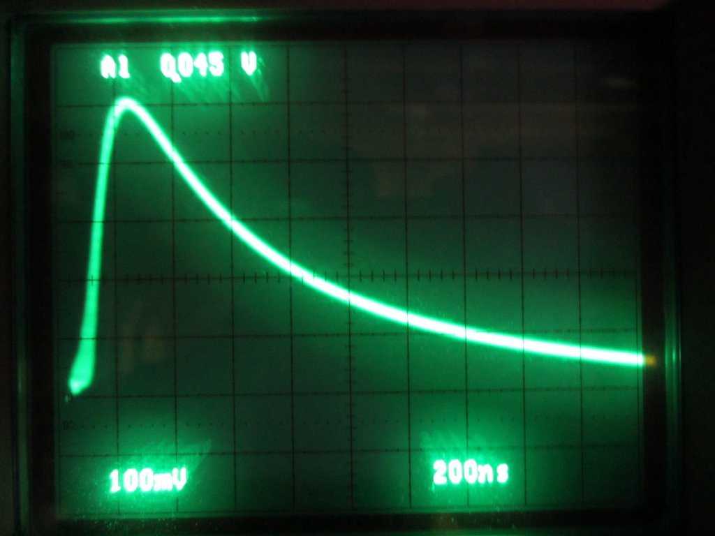

Here is a single pulse viewed at a much smaller time base. As you can see, the rise time is no where close to the nano-second rise time we get using the standard configuration, but at under 100ns the rise time is still pretty fast.
Because these narrow pulses have extremely wide frequency spectrum, you can easily pickup the 500Hz audio signal using an AM or shortwave radio over the entire frequency range. The wide frequency spectrum serves as the carrier frequency and the pulse intervals becomes the audible signal. And the negistor pulser shown above can operate over a wide range of supply voltages, from around 20V upto more than 100 volts. As the voltage changes, the pulse interval changes as well and if you have a radio close by, you can hear the audible tone ramping up and down as you adjust the supply voltage.
TP1

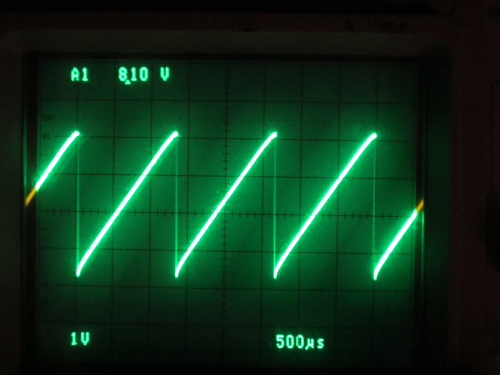

The waveform at the emitter (TP2) illustrates the charge and discharge of the capacitor. Since the capacitor is only charged briefly to a fraction of the supply voltage before avalanche breakdown occurs, the linearity of the sawtooth signal is quite excellent.
TP2
