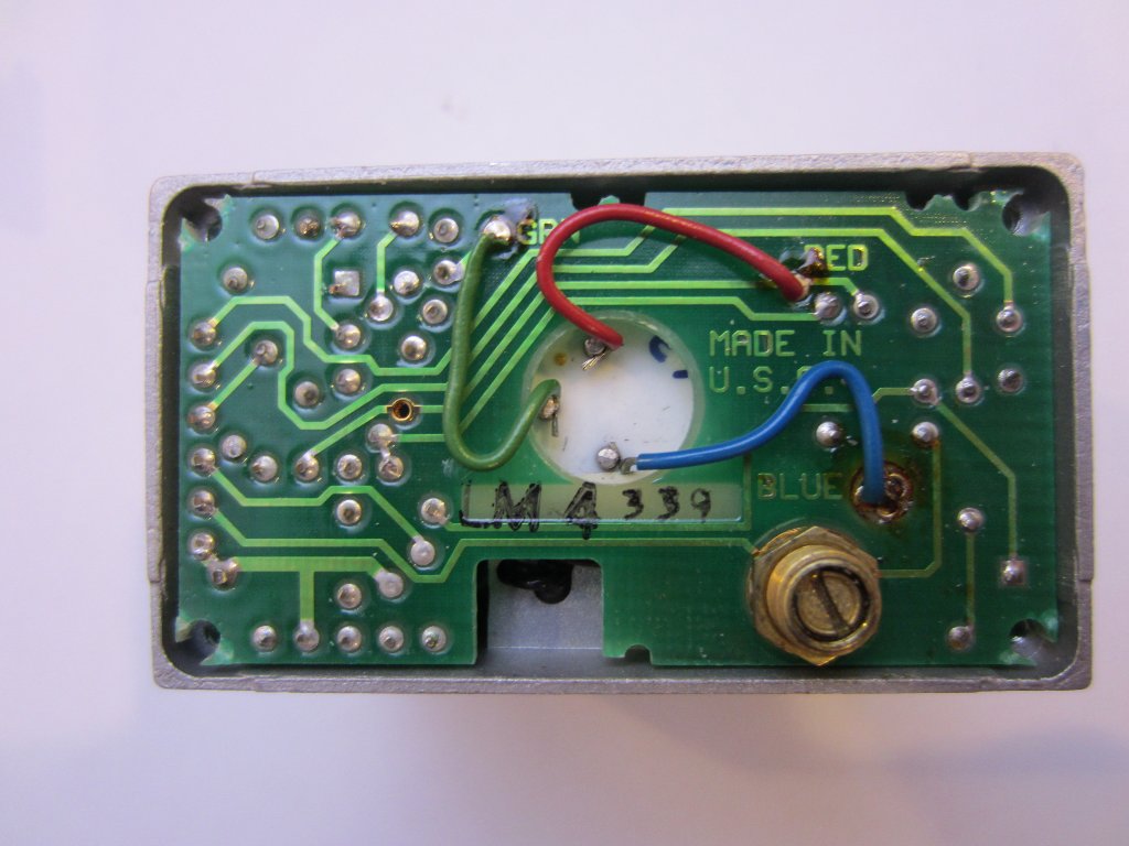

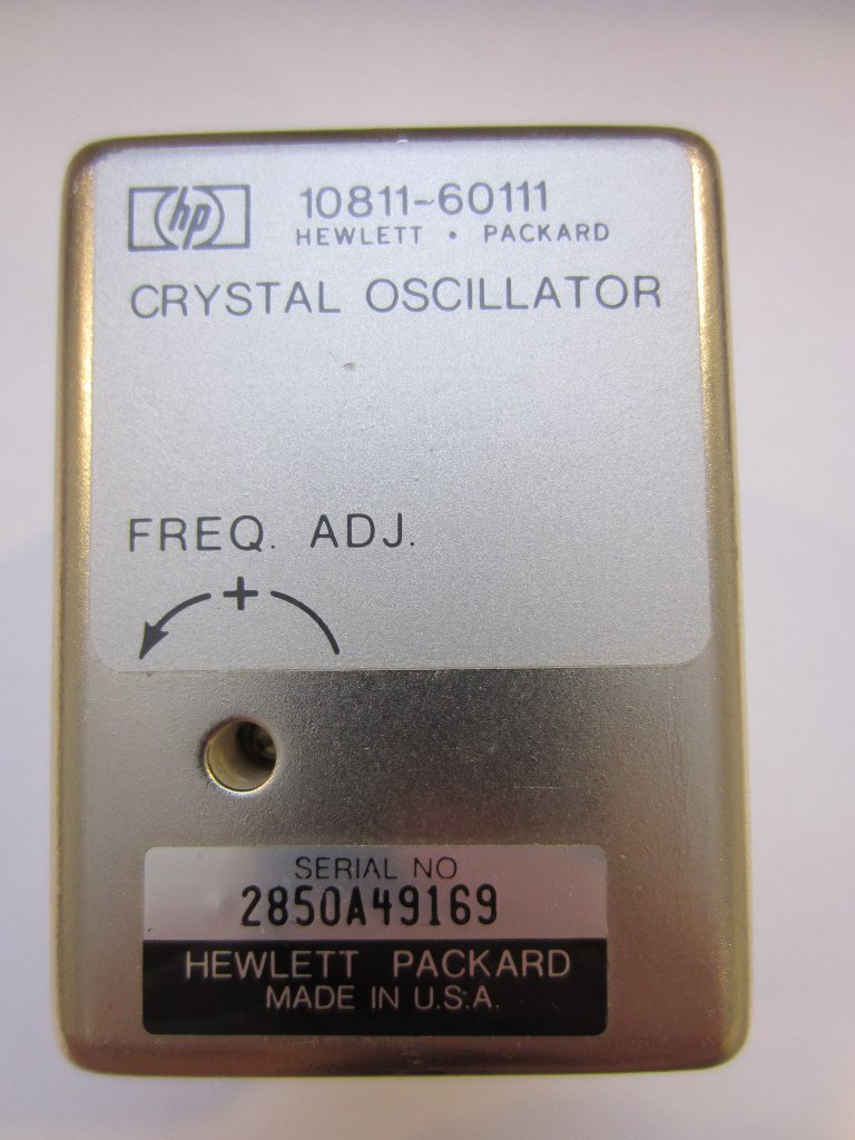

As mentioned in my previous post, the crystal oven is plugged into a socket and further secured onto the motherboard via two screws. To remove the OCXO, I first removed the bottom cover of the HP 5350B and then unscrewed the two screws holding down the OCXO.
Here are a couple of pictures of the OCXO. Look at how shinny those gold-plated PCB contacts are!
HP5350B_OCXO_1 HP5350B_OCXO_2
According to the service manual, pin 14 and pin 15 are the oven power supply (pin 14 is positive). Measuring the resistance between these two pins indicated there was an open circuit inside.

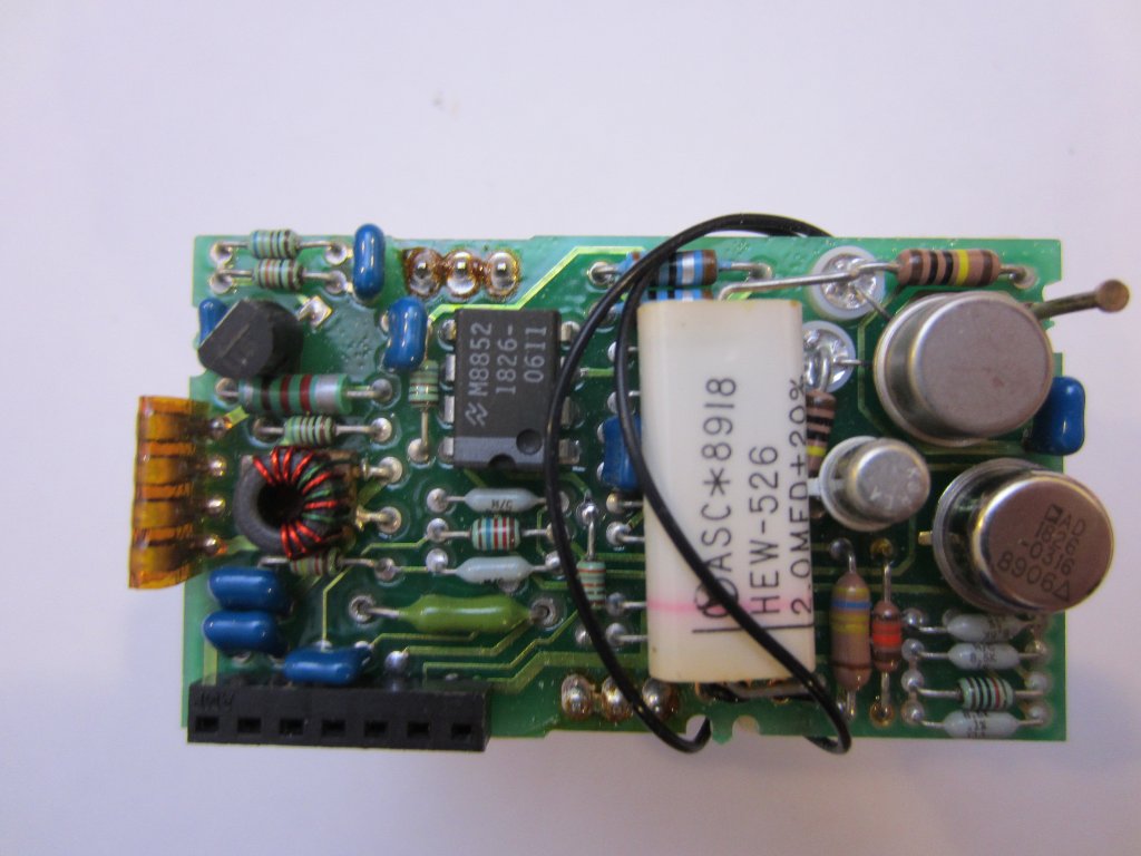

The 15-pin board connector can be freed by removing two screws on the side. The thermal fuse can be partially seen in the picture on the left below (the green resistor like component to the left of the ribbon cable). Since the resistance measurement between the oven power supply pins suggests an open circuit, there is a high probability that the thermal fuse could be blown.
The OCXO is easily serviceable. After removing the bottom cover and a piece of heat insulation foam, you can see the the controller board (the oscillator is mounted near the center of the oven within the oven mass).

The picture on the left below is the top side PCB of the oven assembly after removing the oven mass from the insulation foam casing. In the picture to the right, you can see the thermal fuse (green) right above the ribbon cable connector.
And sure enough, the thermal fuse is open. Everything else, including the Darlington transistors seem to be just fine. At the first glance, it appeared that the solder joints of the thermal fuse were dry. But after closer examination, it turned out that this wasn’t the case. Unlike other components which were soldered directly onto the board, the thermal fuse was soldered into two tin-solder cups — presumably for easy replacement (I have seen this technique in my HP 6181C teardown).
HP5350B_OCXO_7 HP5350B_OCXO_10
I didn’t have a comparable thermal fuse on hand, so I followed the service manual’s suggestion and temporarily put a jumper in place. A quick test showed that the oven drew roughly 500mA when pin 14 and pin 15 are connected to a 24V power supply (current limited to 600mA), and after a couple of seconds the transistors were warm.
The picture to the left below shows the controller board after my quick fix, and the one on the right shows the failed thermal fuse.
HP5350B_OCXO_8 HP5350B_OCXO_9
