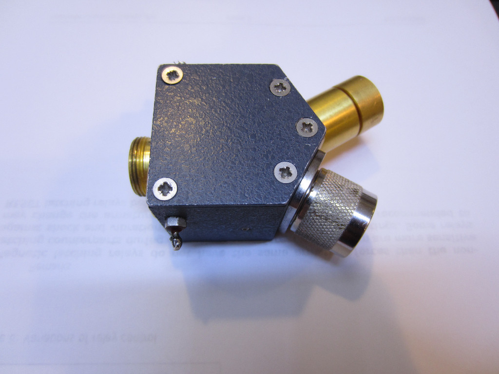

The relay I am using here is a latching RF relay. It is used to switch the input signal between its two outputs. For this particular relay, the input has an APC-7 connector. One side of the output has an N connector and the other side is 50 Ohm terminated. Although this relay is an RF relay, the method I described below is applicable to any latching relays.
rfrelay

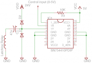

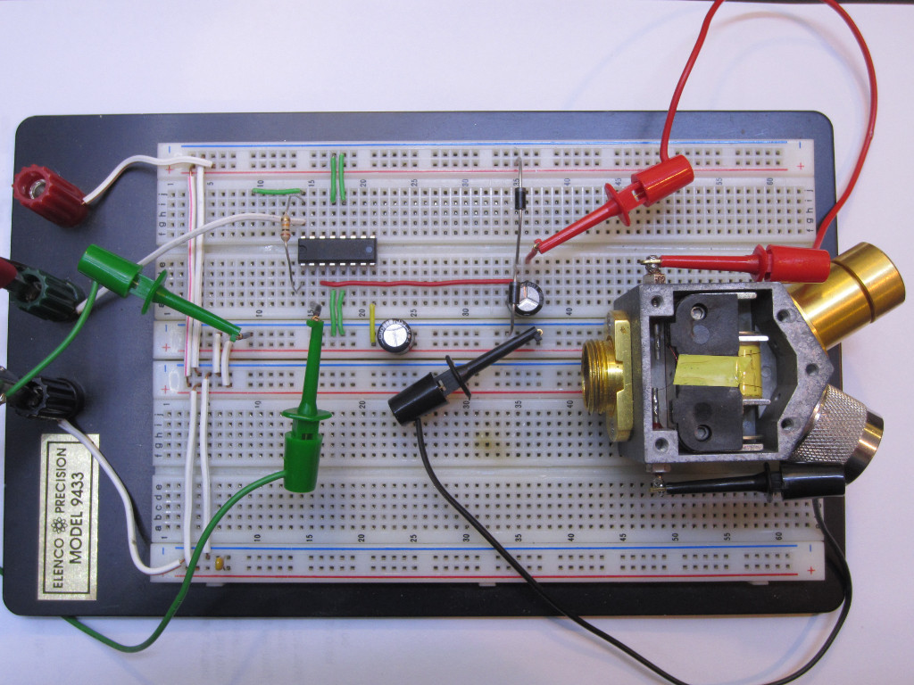

Many dedicated ICs (such as MAX4820, MAX4821) can be used for driving such relays. Because of nature of the latching relay, no H-bridge is needed (although you can definitely use an H-bridge, but it would be wasteful). The circuit I have here uses an SN754410 quad H-bridge driver chip. Only one of the four half-bridges is used. In fact, you can pretty much use any circuitry with a push-pull output configuration as long it can provide sufficient impulse current.
LatchingRelayCircuit
The key element in this circuit is the output capacitor. When the push-pull output is high the current flows through the capacitor to charge it and this impulse current also turns on the relay. Once the capacitor is charged, the output current reduces to zero. When the relay direction needs to be reversed, we can simply pull the output low and positive terminal of the capacitor is grounded in this case. Thus the current flows the other way around through the relay coil, engaging the relay while discharging the capacitor.
The minimum capacitance required can be calculated via
\[C_{min}\ge\frac{4L}{R_{coil}^{2}}\]
as pointed out in this application note. In practice though, a 10 to 100 microfarad capacitor would be sufficient for most types of latching relays.
drivingcircuit
