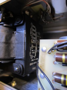

Here is a picture of the high voltage transformer from another angle, you can clearly see the voltage ratings on the side.
493A_13

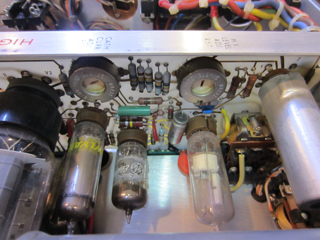

There are only a few potentiometers to adjust when tuning the TWT. The ones in the picture on the left adjust the grid voltage of the tube which in turn controls the gain, and also the frequency responses of the modulator. The ones on the right are responsible for the cathode current, and anode voltage.
493A_9 493A_10
