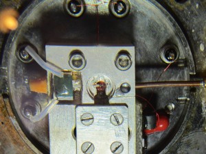

Here are two pictures of the YIG oscillator itself. The two insulated wires at the top are the wires to the PTC heating element. As it turned out, the measured 240 Ohm nominal resistance was correct after all. Since the area heat needs to be maintained is extremely small, this low-power heater is actually sufficient to keep the YIG sphere heated at around 100 degree Celsius.
The two magnetic wires coming in from the right are connected to the FM coil. And the Gunn bias voltage is supplied from the bottom (ground referenced). The picture to the right shows a close-up of the Gunn bias supply circuitry.
YIG_1 YIG_2
The center of the YIG oscillator is protected and shielded by a small piece of copper on the top. After carefully removing the thin copper cap, we can see the core of the YIG oscillator. From the picture below, you can clearly see the orthogonal coupling wires around the YIG sphere (click to see the picture in higher resolution). The actual size of the Yttrium iron garnet is tiny. If you look carefully, you can see a small shinny spot in the center of the coupling wires and that is the YIG sphere. The diameter of the YIG sphere is around 1 mm. The small coil surrounds the YIG sphere is the FM coil.
