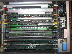

Unlike most of the rack mountable test equipment which offer both front panel inputs and back panel inputs, it appears that Wavetek 859 only came with the rear panel input option. Clearly, it was meant to be mainly used in an automated test environment. The unit I got has option 001 (GPIB) and option 010 (dual channel) installed. As you can see from the picture below, all plugin slots are occupied.
In the teardown below, the cards were removed in sequence from the bottom to top.

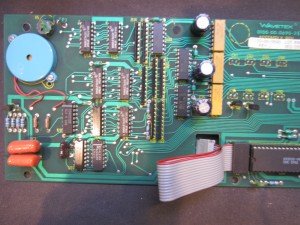

The first set of pictures are for the GPIB interface board (with the optional MATE interface). Compared to many modern single chip solutions, this board certainly looks overcrowded. But it does offer an isolated GPIB interface. The optocouplers used here are 6N136‘s and 4N26‘s. The GPIB IC is a Motorola MC68488P. The silkscreen “S” with an arrow on the board indicate the direction for wave soldering.
On the other side of the GPIB board, there is a small daughter board. I am not entirely sure what this board does. It has a DAC1006 DAC chip on it. The daughter board is mated onto the main plugin board via headers and secured via standoffs.

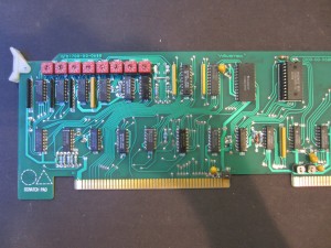

The next board is the main controller board. The microprocessor used here is a Philips SCN2650 (I couldn’t find any information on this chip though). The MCU is clocked at 10 MHz.The firmware is stored on five 16 Kb MM2716 UV erasable ROM. There are two empty sockets, I am not sure if they are intentionally left blank for some optional firmware packages or they are missing. If these two sockets were supposed to be occupied, it would have explained why the unit failed to boot at the first place.

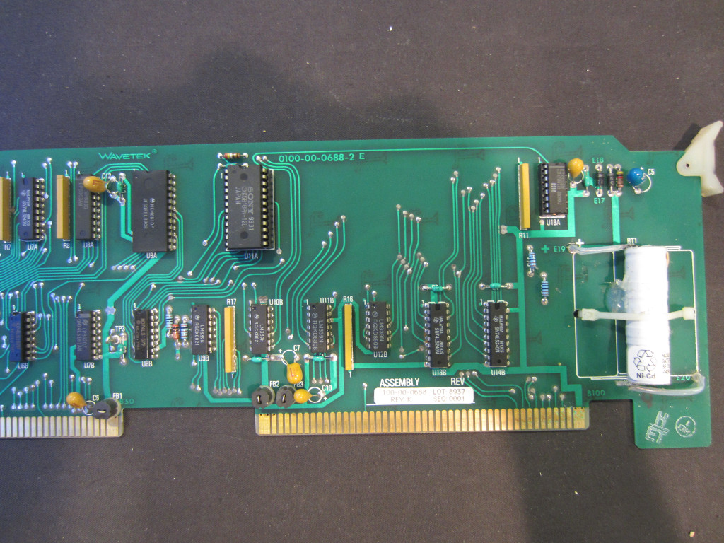

The next board in line is what I believe the circuitry used to store various timing parameters, as it contains a battery backup and a 16 Kb SRAM chip (Sony CXK5818). like many test equipment back then, parameters are stored in battery backed-up SRAM (flash memory had not been invented back then yet).

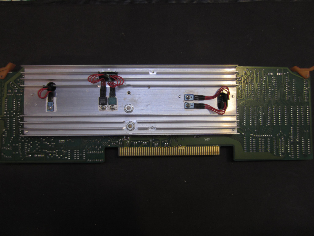

The power transistors responsible for driving the output are mounted on a massive heat sink on the back of the board.
