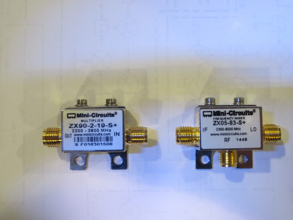

I ended up choosing Mini-Circuits’ ZX05-83-S+ 2300 MHz to 8000 MHz level 7 mixer as my work will mainly be dealing with frequencies under 2 GHz. This mixer has excellent performance in the 0-2.5 GHz base band for mixing the 3.6214 GHz to 6.2 GHz LO signal with the 3.6214 GHz IF. This mixer is relatively inexpensive, retails for less than $50. As you will see later, even though this mixer is not rated for RF signals as low as the IF frequency for the first harmonic band (321.4 MHz), it is still usable in the 5.8 GHz frequency band, but the performance does suffer suffer a bit.
If you need to work in the first harmonic band more often, you probably want to consider a wide band mixer such as Mini-circuits’ SYM-63LH+ level 10 mixer, which has a reasonable performance curve between 1 MHz and 6 GHz. It only costs slightly more than $10, but only comes in surface mount package.

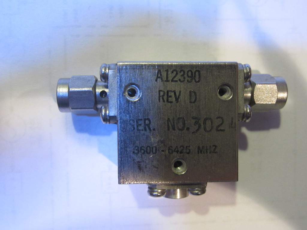

LO Isolation

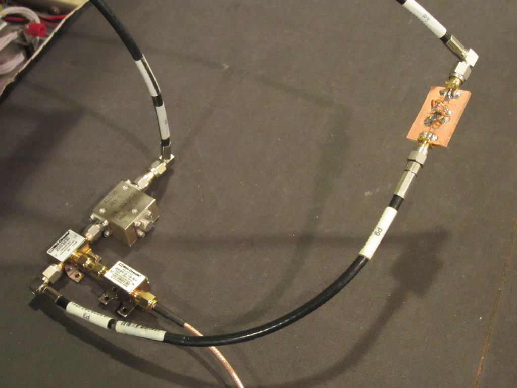

Although it is possible to connect the LO output directly to the mixer’s LO input, the reverse LO leakage will reduce the available dynamic range. So I decided to add an isolator between the LO output from the spectrum analyzer and the LO input to the mixer. I happen to have a Harris A12390 isolator on hand, it offers 20 dB isolation from 3.6 GHz to 6.4 GHz which covers almost the exact LO frequency range for the base band. Although from my experiment data shown later, the inclusion of the isolator only added marginal benefits. I suspect that adding a narrow bandpass filter centered at 3.6214 GHz would help as the output from the frequency doubler has a lot of unwanted signal components.
Alternatively, an attenuator in conjunction with a low gain amplifier could also be used to reduce the back feeding of the LO signal.

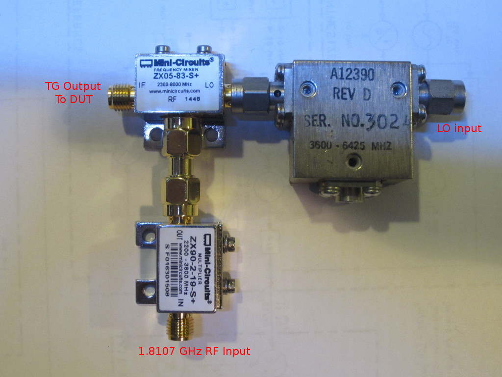

Putting It Together

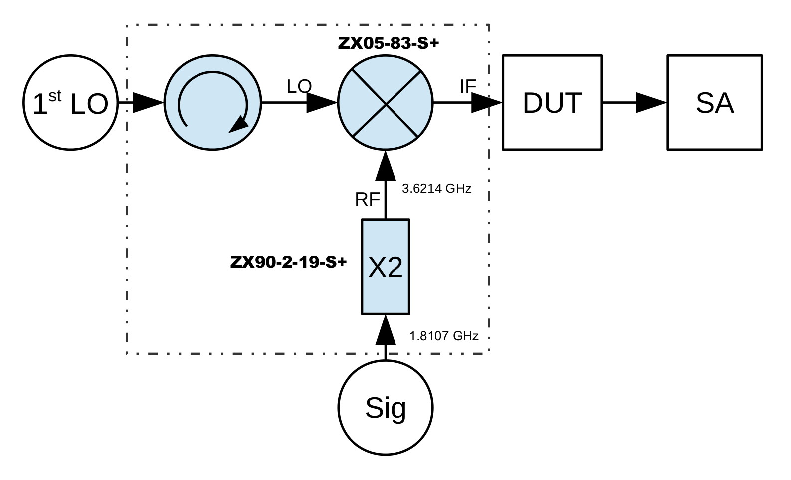

The diagram below shows the components used in my tracking generator: the mixer (ZX05-83-S+) takes signal from the 1st LO and mixes it with the 3.6214 GHz signal from the frequency doubler (ZX90-2-19-S+) and generates the 0-2.5 GHz tracking signal for the base band. The input to the frequency doubler is taken from my HP 8642B which is phase-locked to the HP 8566B.
trackinggenerator

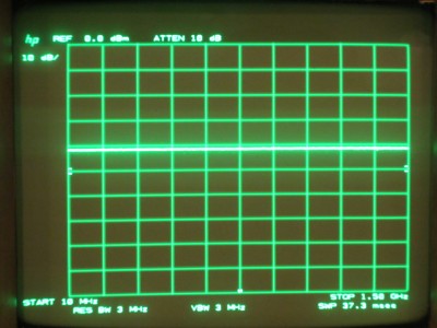

The maximum signal strength of the tracking signal is limited by the LO signal strength and the RF signal strength (the output from the frequency doubler). The frequency doubler used here limits the maximum input power to 10 dBm, and the output 3.6214 MHz frequency is just under 0 dBm. Adding the conversion loss from the mixer, the tracking signal is at around -7 dBm which still gives at least 25 to 50 dBm of dynamic range.

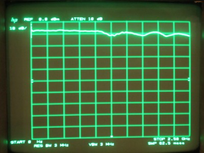

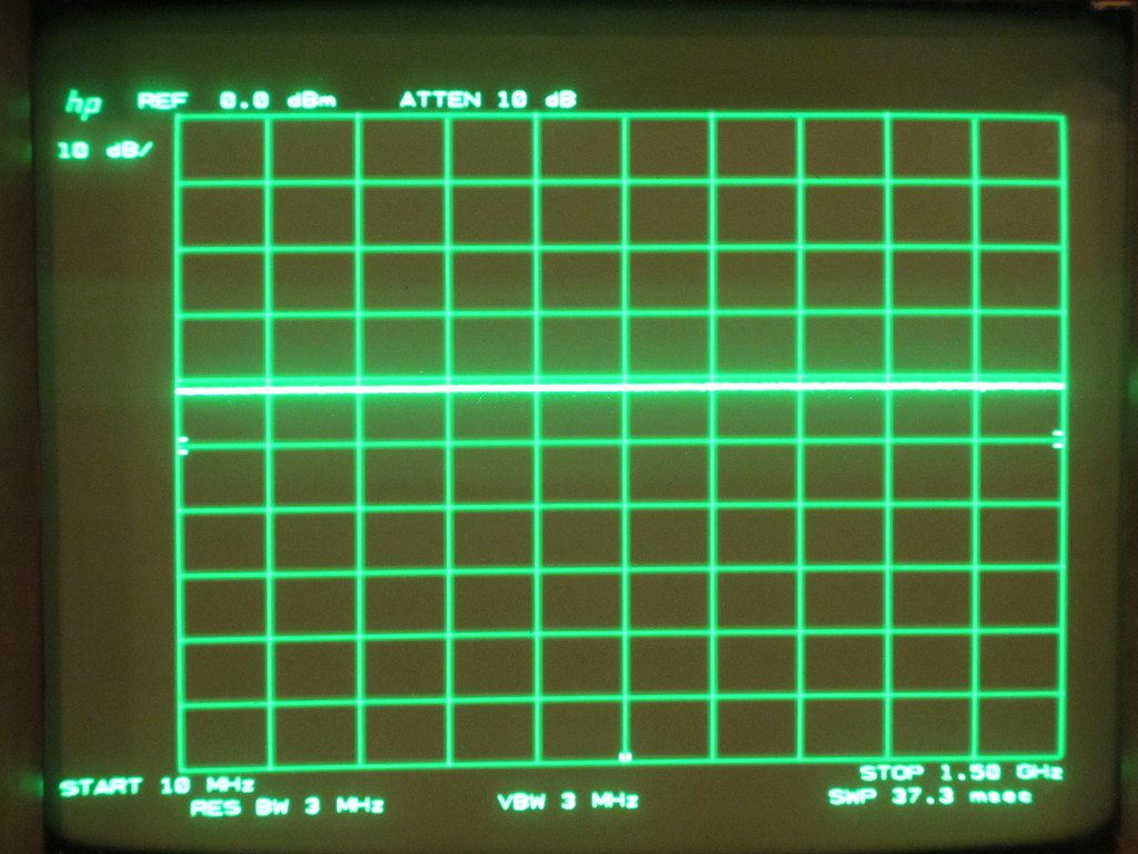

The quality of the tracking signal is actually quite good. It is reasonably flat considering that this is taken from the LO output directly, without using a leveling amplifier.

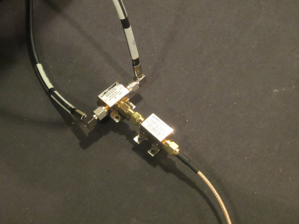

The picture to the left below shows the actual tracking generator components. The picture to the right shows the noise floor when the spectrum analyzer’s input is disconnected. The baseline noise floor is not as ideal as I had hoped. At between 1 GHz to 1.5 GHz there is a significant rise in the baseline noise and because of this we only get about 25 dBm of dynamic range within this frequency region.

The addition of the RF isolator (3.6 GHz to 6.4 GHz) does seem to have improved the performance a little bit, although not as much as I had thought. The picture to the left below shows when the isolator was taken out of the equation and the picture to the right below shows the measured noise floor without using the isolator. As you can see, the isolator seemed to have narrowed the noise in the “problematic” band quite a bit but only managed to reduce it by a few decibels in the 1 to 1.5 GHz region.
But this picture does suggest that you probably can do away with the RF isolator, which could reduce the BOM even further.

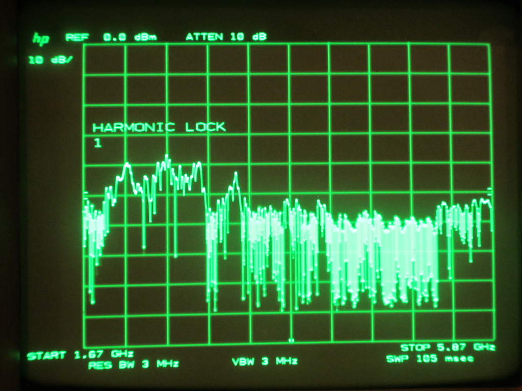

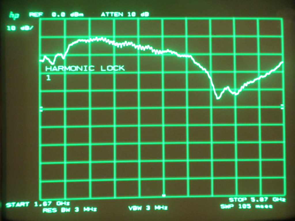

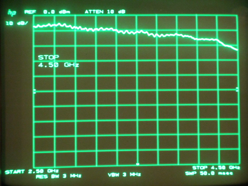

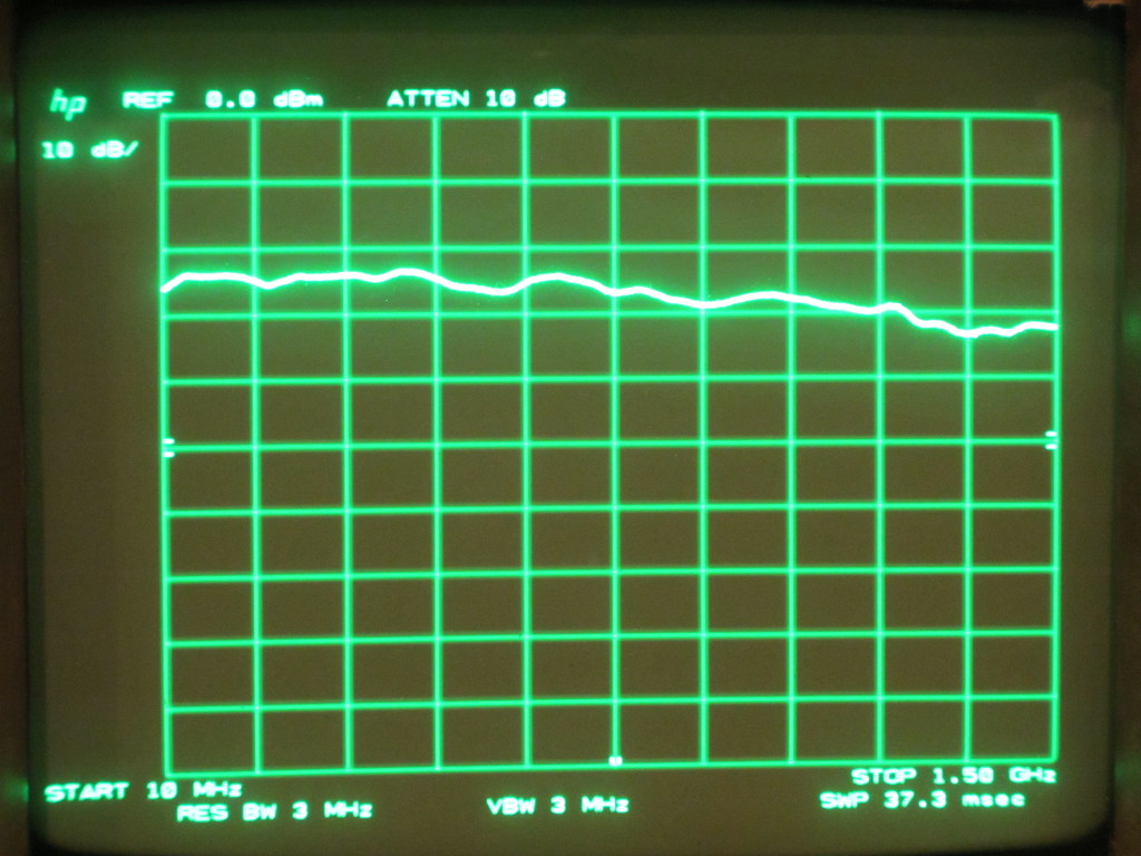

For the 1st harmonic band, a 321.4 MHz signal from the HP 8642B is coupled directly into the RF port of the mixer without using the frequency doubler. While the tracking signal’s strength varied wildly between 1.67 GHz and 5.87 GHz (with the 1st harmonic band locked), the performance is actually quite reasonable between 2 GHz and 4.5 GHz.
Note that for the first harmonic band the 321.4 MHz signal was adjusted to 10 dBm which was inputted into the mixer directly (as opposed to the 0 dBm signal via the frequency doubler in the base band), this additional power helps improve the dynamic range.
Since the mixer (ZX05-83+) used here is technically not rated for frequencies under 2.3 GHz (the IF for the harmonic band is only 321.4 MHz), the performance we see is actually quite good. Of course, you can always swap for a better spec’d mixer if you find yourself needing to characterize devices in the first harmonic band more often. I think you should see additional performance improvement with a properly rated mixer.

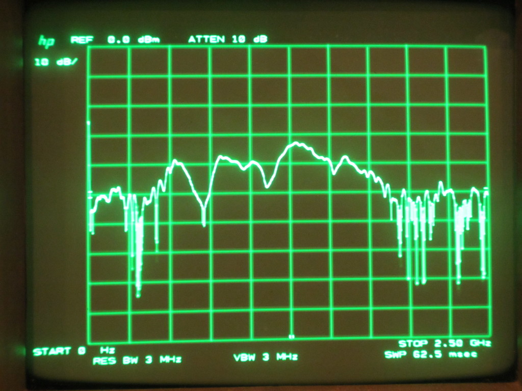

Here is a picture showing the noise floor of the tracking generator in the 5.8 GHz harmonic band.

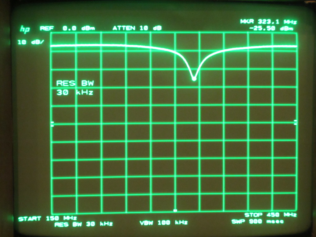

The first experiment below shows the characterization of an LC filter. Because the tracking generator’s output is very flat between 150 MHz and 450 MHz, no trace adjustment was made before the expeirment:
filtertestsetup
Here is the measured result. As you can see from the screenshot below, the resonant frequency of this particular LC filter is at 323.1 MHz.

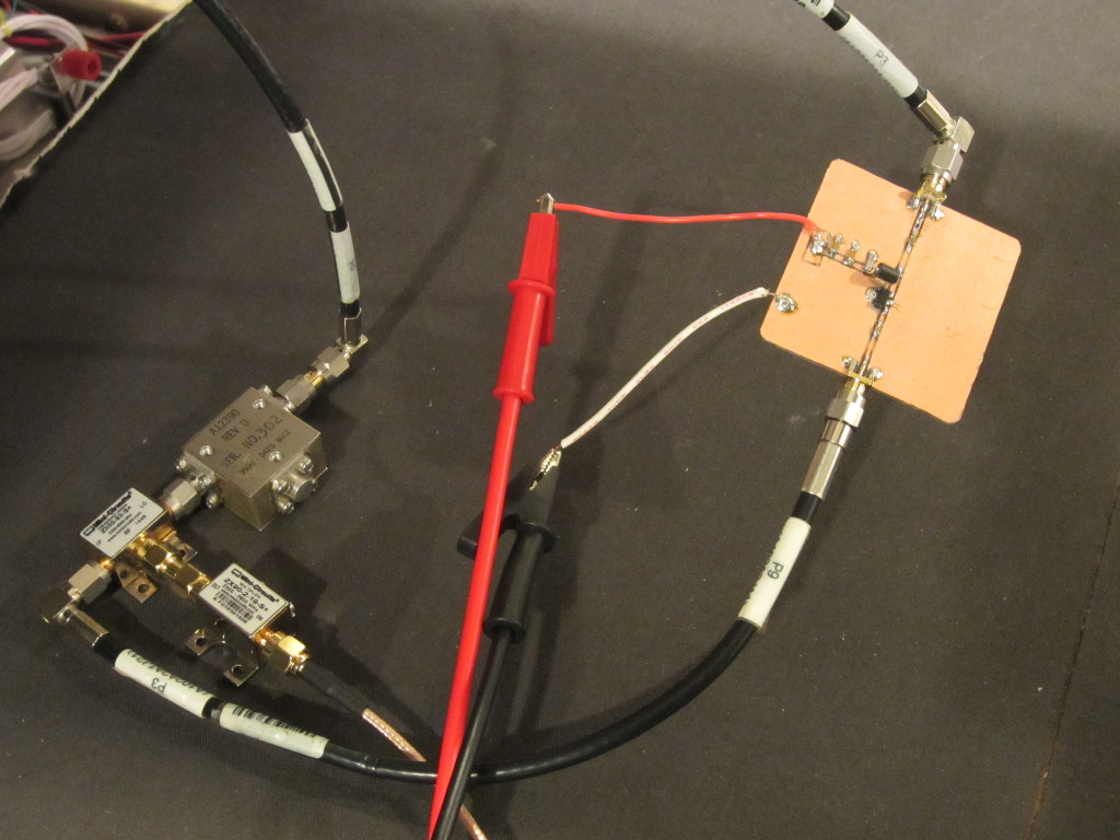

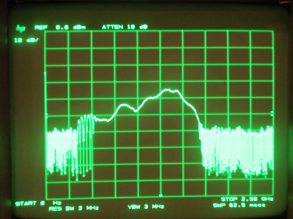

The next experiment shows the gain-bandwidth characterization of an ADL5536. ADL5536 is a 20 MHz to 1 GHz IF gain block with a fixed gain of 20 dBm.
amplifertestsetup
For the measurement, the baseline is lowered to just below -40 dBm (by lowering the RF input into the mixer) and trace arithmetic was used to normalize the baseline between 10 MHz and 1.5 GHz. This is condition is slightly different than what I used during my video demonstration.
baselineforamplifier
And the picture below shows the output level from the RF amplifier between 10 MHz and 1.5 GHz. There are some losses due to the coax used, but the shape of the curve is largely in line with what is specified in the datasheet. And as you can see, the gain of this amplifier rolls off very gradually as frequency increases and thus this amplifier could be used all the way up to at least 1.5 GHz. Of course, at the higher frequency end, the gain is limited to just around 10 dBm.
