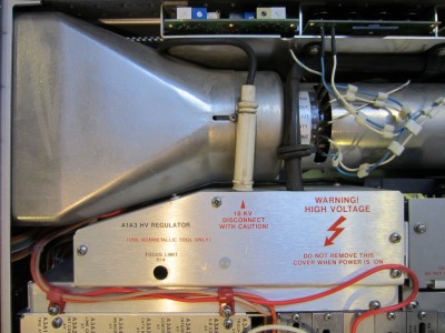

Here is an overall picture showing the inside of the IF/Display unit with the top cover removed:
DisplayTop
The following pictures are the closeups for each areas. All the test points and adjustable components are clearly marked so the unit could be easily serviced by cross referencing the service manual.
DisplayTop1 DisplayTop2
DisplayTop3 DisplayTop4

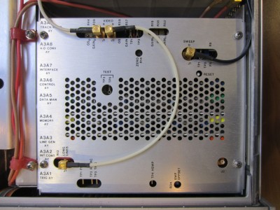

As I mentioned earlier, there was some rattling noise inside the shipping cardboard box for the analyzer unit. The noise was partially due to the two snapped off handles hitting against the case. It became apparent after I removed the cover to the three controller assemblies that at least two of these cards had become loose, this could have also contributed to the rattling noise. Luckily, there’s no other visible damage.
A12A16A15

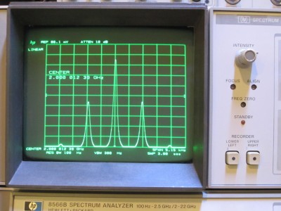

The picture to the left below shows the 2 GHz signal with frequency modulation. And the image to the right shows the same 2 Ghz carrier with 100% amplitude modulation. The amplitude was displayed in linear scale and the side lobes from the AM signal can be clearly seen at 50% level of the carrier.
2GFM 2GAM

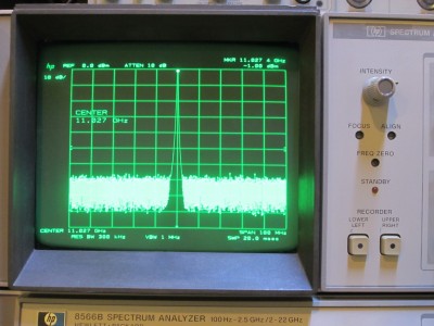

Here I was testing the 2-22 GHz band of the analyzer using a 11 GHz signal generated from the Wavetek 907:
11GHz
