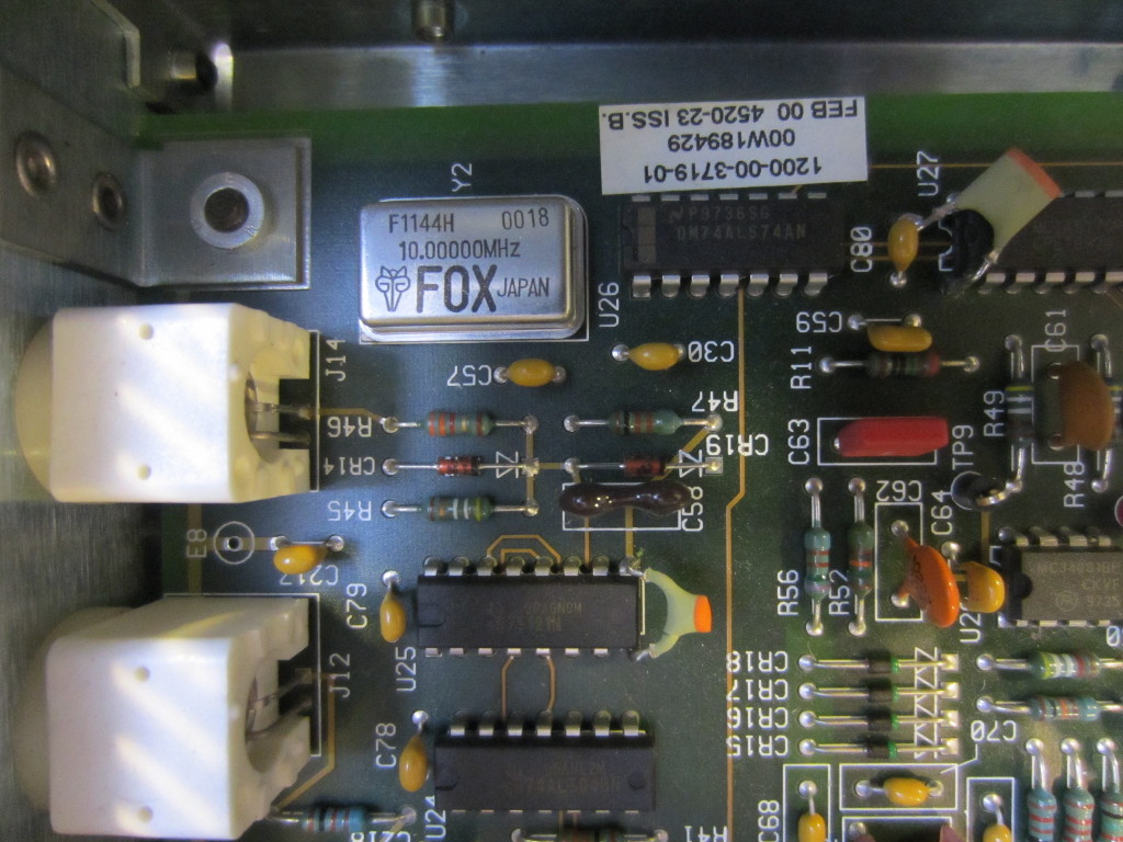

The main clock crystal used in Wavetek 395 is a FOX F1144H series 10 MHz oscillator. With a frequency stability of 100 ppm, it is not a superb frequency reference by any means. But you can always use an external more accurate clock source if more stability is needed. From the pictures below, you can see a MC1648 VCO, which is most certain used in a PLL circuit to synthesize the variable clock frequencies required for the arbitrary waveform generation.
w395_mainclock w395_mainclock1

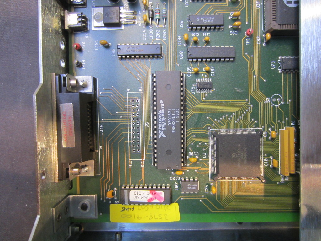

The microcontroller used in the Wavetek 395 is an MC68331CFC16 32bit M68000 compatible microcontroller. You can still buy these MCUs on DigiKey today and they are quite expensive, costing more than $30 each. The unit I got also comes with the GPIB option, so you can also see the scoketed NI IEEE-488 controller chip below.
