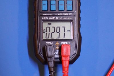

This meter’s display quality is quite good and the viewing angle is also excellent. It seems that those Chinese companies have gotten the LCD manufacturing process down pat as even on the cheapest meters the LCDs are usually of excellent quality. The backlight quality is equally good. The white backlight stays on for 30 seconds according to the manual, which is sufficient in practically all situations.

If you are planing to use this meter as your everyday meter, you will likely to be disappointed. While the voltage measurements are accurate and the speed for both the AC and DC range is fine (roughly 2 to 3 updates per second), the resistance and the capacitance measurements will likely irritate you. The resistance auto-ranging is really slow, it takes a few seconds to cycle through the ranges if you are measuring a kilo-Ohm range resistor. When I reviewed the EnnoLogic eM860T meter I mentioned that the resistance measurement on that meter is painfully slow. Well, compared to this AM03 meter the measuring speed on the eM860T is actually lightning fast. The capacitance measurement range is not particularly useful either. Besides being slow, it is only capable of measuring capacitance up to 100uF. The continuity measurement is not latched so you get the scratchy sound when testing continuity.
The non-contact-voltage (NCV) measurement feature is not as sensitive as I would have liked. For the 120V mains voltage in North America it struggles to sense the close-by mains wiring. That said, the good news is that it does not false trigger like the eM860T.
On the bright side, the frequency measurement range is actually quite more capable than what is specified. The manual specifies the frequency measurement range up to 100kHz. In my test however, I could measure the frequency accurately beyond 1MHz.
