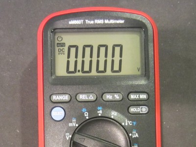

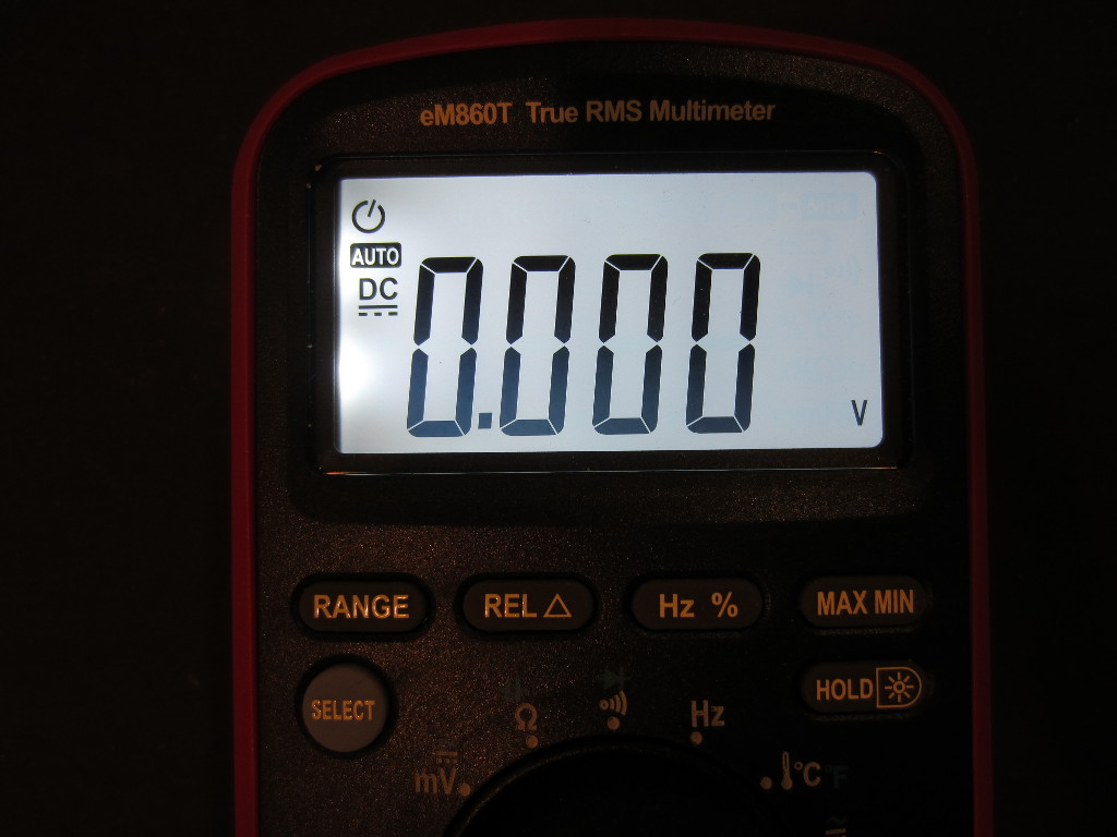

The contrast of the LCD is pretty good although BK precision 2709 probably has slightly better viewing angle. The white LED backlight of this meter looks gorges.
