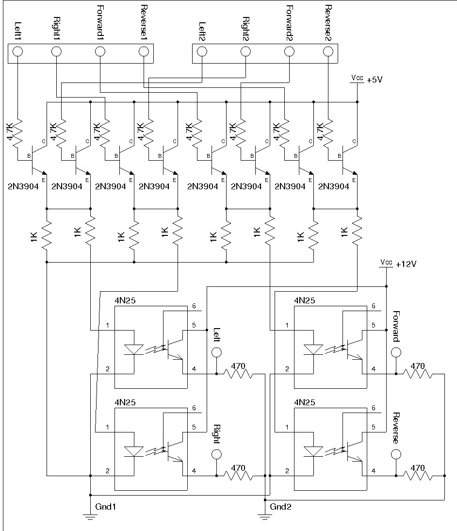

So the idea is to add an Or gate to each of the control pin so that the remote control would continue to work and at the same time the second set of controls can be used by a microcontroller.
The signal’s voltage level on these pins is not the standard TTL level however. To prevent damages to the TTL circuits, I used four opto-isolators to isolate the two different voltage levels.
The circuit is shown below:
![Drive Control Multiplexing Circuit Drive Control Multiplexing Circuit](http://www.kerrywong.com/blog/wp-content/uploads/2011/02/muxcontroller-258x300.jpg)
Eight transistors are used to form four or gates (you can also use a chip like CD4081 for this. I don’t have one on hand but have a lot of transistors lying around).
Depending on your specific design and isolation requirements, the two grounds can either be connected or left disconnected.
