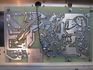

Here are two pictures showing the back side of the board. Like most PCBs in its era, all tracks were tin-plated. You can clearly see where the battery wiring was removed from, towards the top left in the picture to the right.
MV216A_05 MV216A_01
