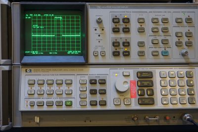

With the power switch cleaned and leaky capacitors replaced, the HP 8620C powered on without any issue and I was able to confirm everything of this unit worked properly. Here is a picture showing the sweep from 9 GHz to 10 GHz persisted on the screen of my HP 8566B spectrum analyzer.
