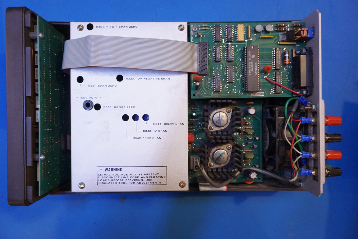

Upon removing the cover, you can see the typical clean Keithley layout inside. From the date code printed on many components, I suspect that this unit was built sometime in late 1987 or early 1988.
While I was doing some testing on the outputs from different ranges using my Keithley 196, which is a 6½ digit bench multimeter, I noticed that some of the ranges were slightly out of calibration. But considering the 30+ years of service life of this unit, it remains quite impressive that the calibration only drifted ever so slightly. And each of the adjustment points is clearly marked, making re-calibration an easy task with the right equipment.
