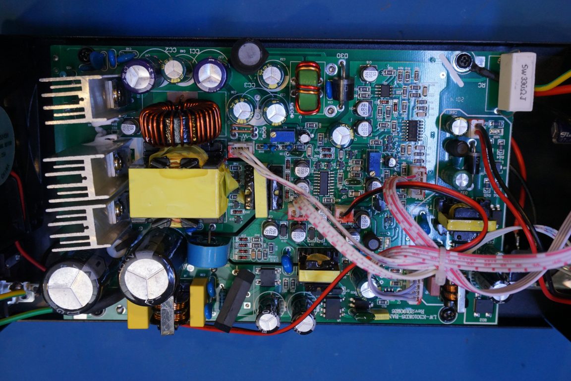

Upon opening up the case, you can see the main switching power supply board below.
Similar switching power supply circuit board design can be found in many of the popular 30V 10A lab power supplies in the market. For instance, you can see the main board from this Topshak power supply (LW-3010EC) and a Kaiweets power supply (PS-3010F) below. The one to the left is from the Topshak and the one on the right is from the Kaiweets.
The main switching controller is an SG3525A PWM controller chip on the secondary of the main pulse transformer. And there is a separate TNY280GN switcher for powering the auxiliary circuit.

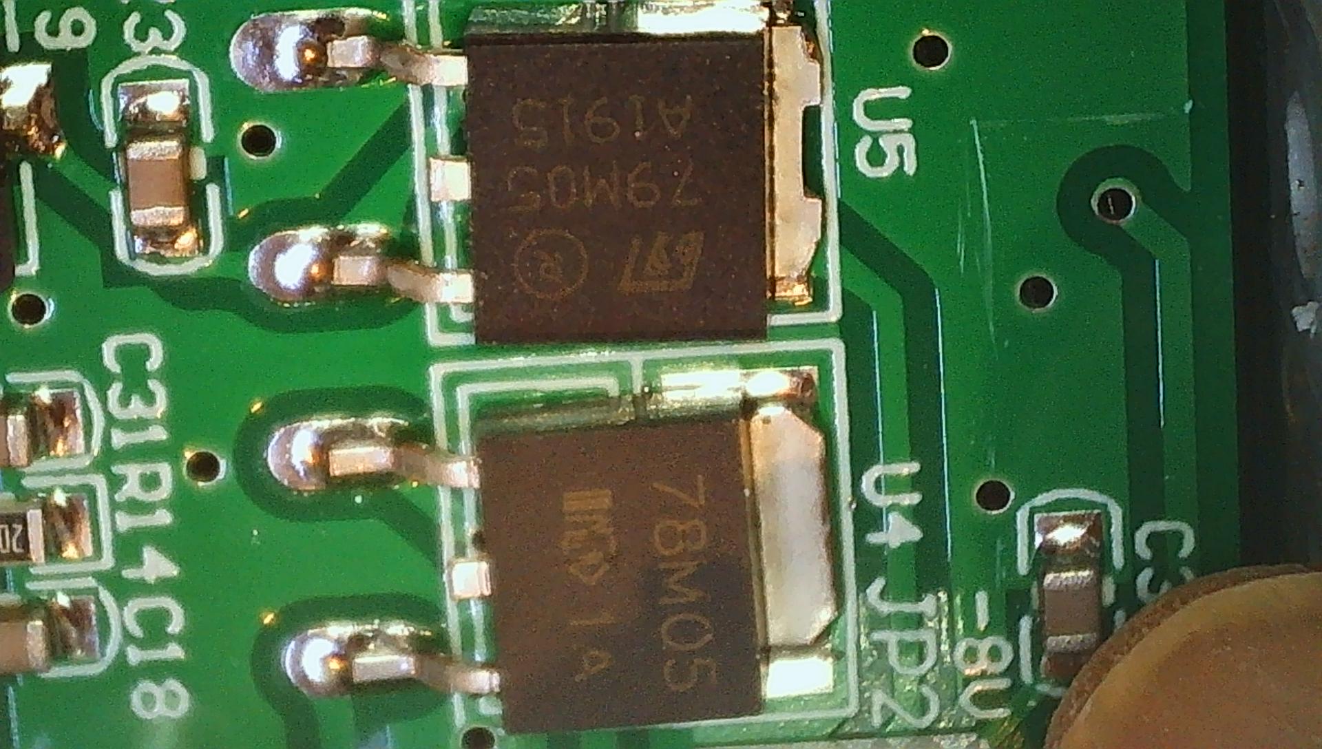

The shift registers (74HC595D) are likely used to drive the 7 Segment displays. Two linear regulators are used to generate the postive and negative 5V rails which are used to power the LM358 OpAmps.
