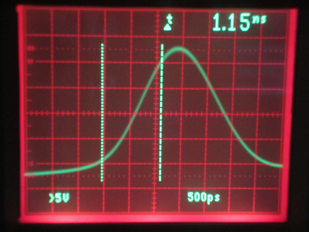

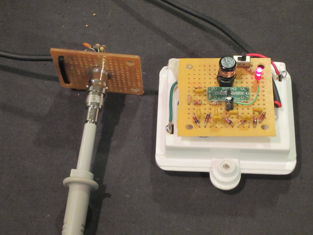

The avalanche pulse generator used here is the one I built a couple of years ago. Before conducting the test, each probe was properly compensated using the probe calibration signal from the oscilloscope. All tests were done using channel one’s 50 Ω DC coupled input.
The picture below shows the baseline rise time of the scope when the pulse generator is connected to channel one directly. The measured rise time is 1.15 ns which corresponds to a scope bandwidth of 304 MHz.

In order to minimize stray capacitance introduced by the probe tip and ground clip, a probe to BNC adapter is used (except for P6131 as I don’t have an adapter for that probe. So a ground spring clip was used in that case). The picture below shows my test setup.
testsetup

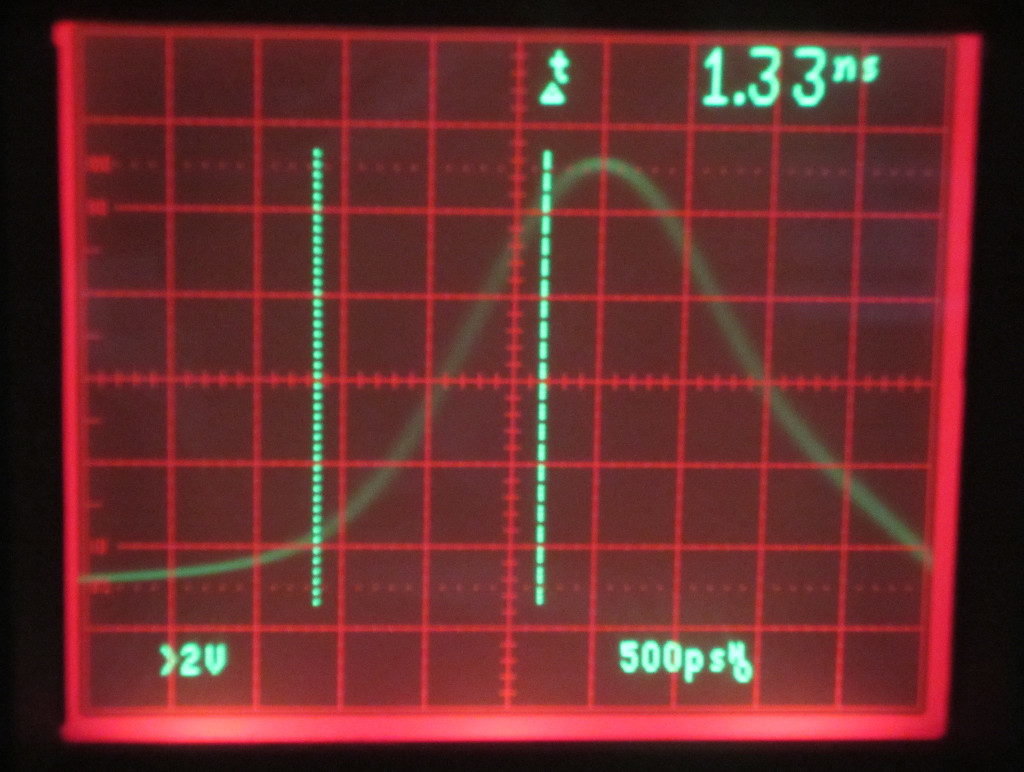

For the Tek P6131 probe (rated 300 MHz), the measured rise time is 1.33 ns which translates into a bandwidth of 263 MHz. As mentioned earlier, I used a ground spring clip for this measurement. So the actual rise time might have been slightly lower than what I measured if I used the same BNC adapter.
P6131_300M

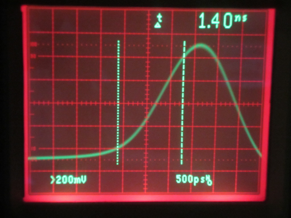

The Rigol RP2200 probe is the default probe for the DS1052E oscilloscope. It is rated at 150 MHz. In the oscilloscope capture below, you can see that the measured rise time is 1.4 ns which corresponds to a calculated probe bandwidth of 250 MHz.
RP2200_150M
