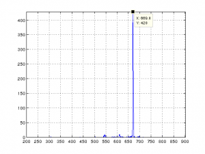

The first measurement shows the spectrum of a red Helium-neon laser. The characteristic spectrum is centered at 632.8nm. For the most accurate measurements, the monochromator must starts at 200nm precisely each time and there should be enough tension on the belt to ensure that it does not slip during the measurement.
HeNe

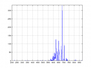

Next let’s take a look at the spectrum of a neon bulb. These gas discharge indicators were quite popular in test gears back in the 70’s (this one was from the power indicator on my HP 6113A power supply). Different spectral lines can be seen clearly.
neonindicator
