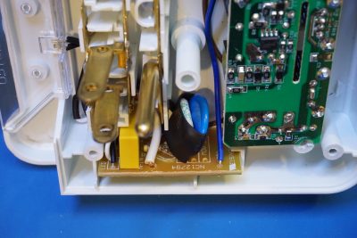

The internal build quality of this MVMT USB adapter is actually quite good. Two PCBs are used in this adapter. One is for surge protection and the other one is for the switching power supply that generates the 5V output rails.
If you look at the picture below closely you will see that the surge protection PCB has footprints for three MOVs, but only one is populated. This will no doubt limit its surge current rating. Perhaps a cost-cutting measure during manufacturing? There is also a blue LED powered by a capacitor dropper that illuminates an acrylic plate that has the word “PROTECTED” embossed on it.
The power supply circuitry stays afloat in regarding to mains earth. But given that a fully isolated switching supply is used here and the apparent wide isolation and the inclusion of isolation slots at many high voltage locations, safety should not be a concern here.
