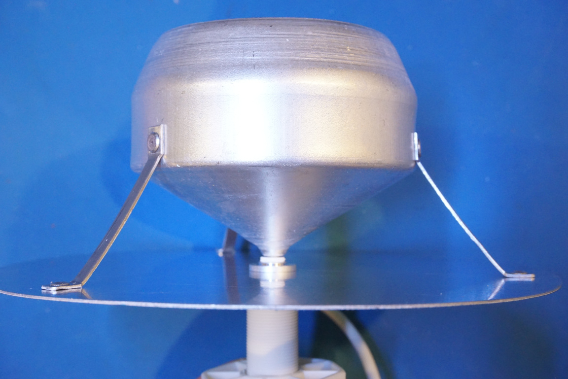

There are a few different options for the indoor antenna. I chose the standard omnidirectional dome antenna given that I have a relatively small house and a single antenna should be able to cover the entire space.
The dome antenna is a broad band antenna. It has a frequency range between 698 MHz and 2.7 GHz. After removing the enclosure, you can see that this is essentially a vertically polarized, modified monocone antenna. The high bandwidth is achieved via the graduated cylindrical cross section.
