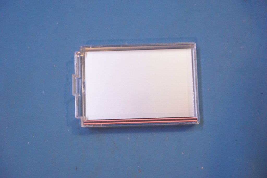

Finally, here are a couple of pictures of the LCD used in this multimeter.
