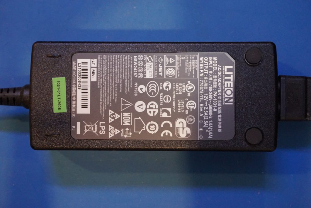

The power bricks I have in mind are these LITEON 12V/2.5A ones as I have quite a few of them lying around. I wanted to use a linear regulator as the output stage as linear regulators have superior power supply rejections and therefore can reduce the ripples introduced by the switching power supplies.

With the controlling circuitry sorted out, let’s take a look at the power brick themselves. Depending on the power bricks, the outputs are either isolated or ground referenced. In the case of these LITEON power bricks, the output negative terminal unfortunately is tied to earth ground. We would need to isolate the output ground from earth ground before these power bricks can be connected in series.
These LITEON power supplies utilize the fly-back topology (see pictures below, the one to the right is with the ground plane desoldered) and in principle the input and output are fully isolated. The only reason that the negative terminal is tied to the earth ground is for added safety (which is a very important reason!).
This power brick has a separate PCB dedicated as the ground plane and both the earth ground and the output negative terminal are tied to it. Besides serving as a ground plane, this extra PCB also protects the components on the back side of the main PCB. So instead of removing the ground plane, we can simply desolder the earth wiring from the three-prong socket.
The picture to the left below shows the ground plane PCB. And the picture to the right below shows the added reverse protection diode.
Note that by removing the earth ground, we also removed one of the safety protection mechanisms. In the event that the primary and secondary of the pulse transformer becomes shorted for example, the output would become live and creating a very dangerous situation. A GFCI outlet should be used with these modifications to reduce the risk of electrical shock.
