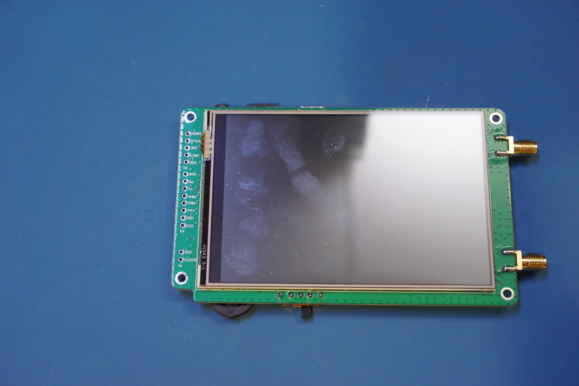

In this blog post, let’s take a look at some of the teardown pictures.
![](http://www.kerrywong.com/blog/wp-content/uploads/2023/06/tinySAFront-1024x684.jpg)
![](http://www.kerrywong.com/blog/wp-content/uploads/2023/06/tinySABack-1024x684.jpg)
tinySA uses a single PCB design. Thanks to the clip-on shielding cans, I was able to remove them and reveal the circuitry underneath.
tinySA uses the standard heterodyne swept spectrum analyzer technique. Input signal is mixed with the LO and then the down converted signal is further processed by the onboard processor.
