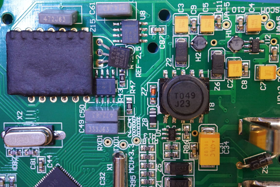

Here is a close up of the voltage reference section, the larger 14 pin device is presumably some kind of thick film device, some precision resistor network perhaps? The voltage reference used is a 2.5V LM385.
