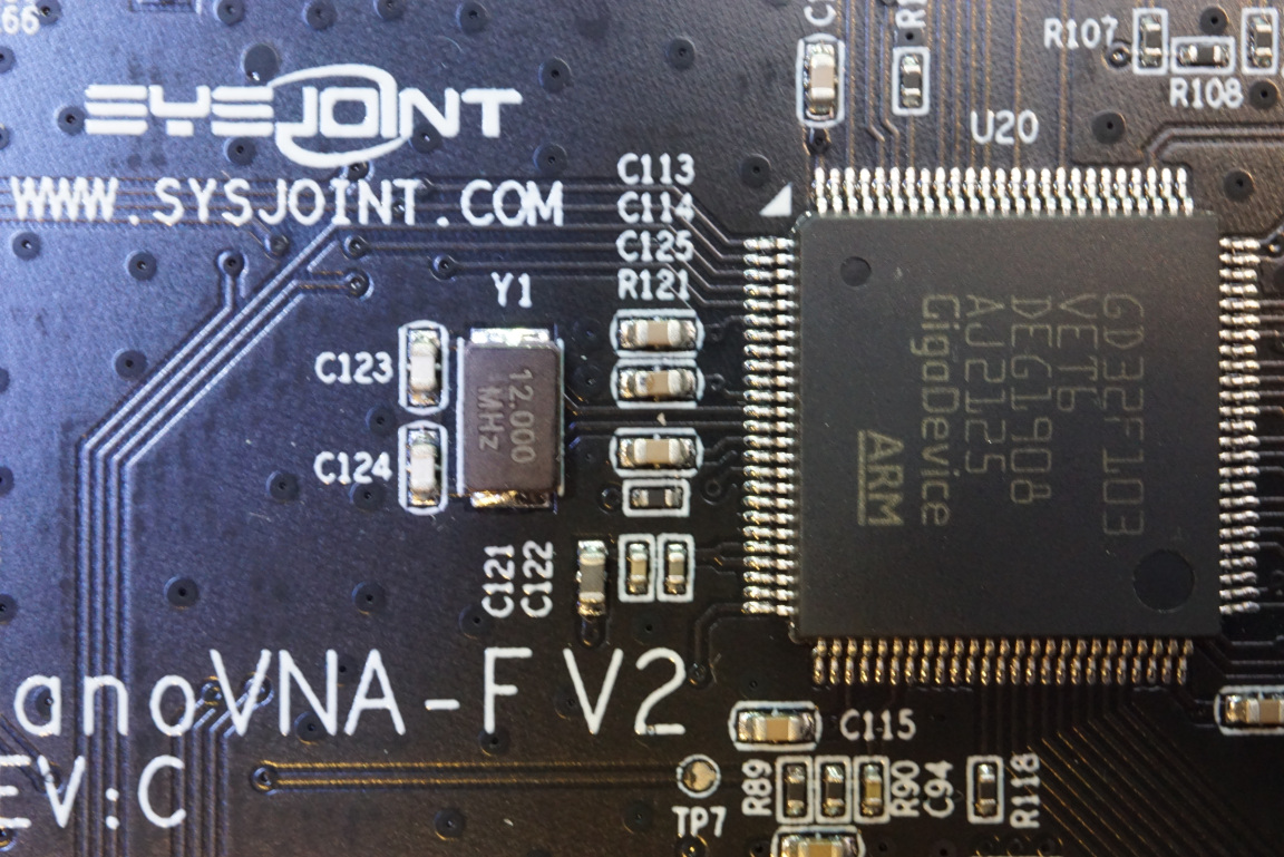

Another improvement in the V3 is the MCU. In V3 an ARTERY AT32F403 is used which has an ARM Cortex M4 core. Compared to the GD32F103 used in the F2 this is a significant improvement. The maximum clock speed is doubled for the AT32F403 which contributes to the significant performance improvement compared to the V2.
![](http://www.kerrywong.com/blog/wp-content/uploads/2023/08/MCU-1024x684.jpg)
![](http://www.kerrywong.com/blog/wp-content/uploads/2022/01/GD32F103-1024x684.jpg)
