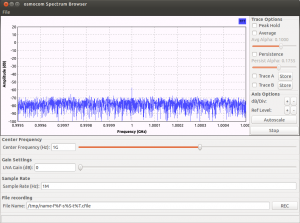

First, let us examine the noise floor of the RTL-SDR. The following screenshot shows the spectrum centered around 1GHz when there is no signal at the input.
osmocom_fft -s 1M -f 1G -g 0 –fft-size=4096 –fft-rate=16
Note that the vertical axis is in dB (amplitude) and not the dBm used in spectrum analyzers! Since we only care about the ratios if we measure a known 0 dBm (on 50Ω) reference signal, we can easily shift the chart and figure out the dBm of our signal power. So I measured a 0 dBm signal and the amplitude ratio happened to be 0 dB (this means we can simply use this figure as our dBm reading).
From the graph we can see that the noise floor is at roughly -70 dBm except for the DC spike in the center (independent of frequency band) which is at around -57 dBm. Because the SDR does not have an adjustable attenuator, we typically want to set the LNA gain at 0 dB. Any gain higher than a few dB will increase the noise floor and thus reduce the dynamic range of the spectrum analyzer. Also, due to the non-linearity of the LNA, you will see significant number of spurious signals through out the observation frequency band if the LNA gain is set higher than a few dB.
