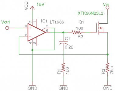

The circuit I used to drive the MOSFET is largely the same as what I used previously. But since I wanted to be able to sink large current (tens of Amps), I used a 50A/75mV current shunt as the current sensing resistor. Since the voltage drop across the shunt resistor is very small (1.5mv/A) a low input offset, rail-to-rail OpAmp is necessary to ensure accurate current setting. Among the OpAmps I have, LT1636 seems to be a good choice as it is rail-to-rail, has low input offset and has a wide Vcc range. The test circuit is shown below. The control voltage comes from my EDC/Krohn-Hite MV216A DC Voltage Standard.
Correction, the shunt resistor value R3 in the schematic should be 1.5 mΩ not 75 mΩ. It is a 75mV 50A shunt.
