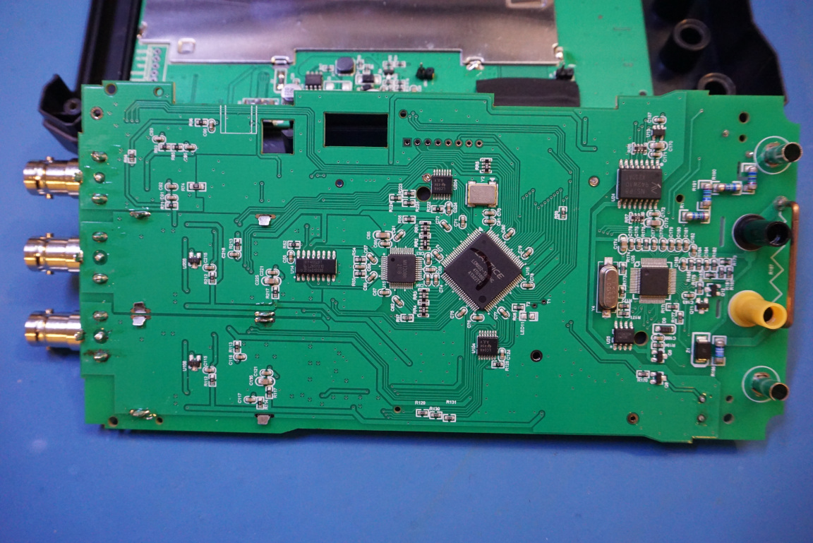

The shielding cans for the channel one and channel two input sections are unfortunately soldered onto the main board, so I did not take them out. The section in the picture to the right below is near the signal generator output. There are a couple of 74HC4051 multiplexers. The 8 pin SOIC chip to the left is a GS8092 rail-to-rail OpAmp which has a bandwidth of 350 MHz.

As mentioned earlier, the two boards are soldered together via two header pins. By the look of it, at least one of the header pins is for ground connection. This design in my opinion is unnecessary as the top board is securely screwed on, the two boards could’ve simply be mated together if needed instead of being soldered together.

The FPGA used in this ET829 is a Lattice LCMXO2-1200HC chip, which has 1280 logic elements. This is essentially the same FPGA used in the Hantek 2D72. The ADC used for the oscilloscope input channels is an MXT2088 8-bit dual channel 100 Msps analog to digital converter chip. This is the same chip used in the Owon HDS272S. It makes sense as the maximum sampling rate of ET829 is 200 Msps when a single channel is in use and this rate halves to 100 Msps when both channels are used. The sampling rate for the Owon HDS272S is spec’d at 250 Msps however, perhaps the ADC is overclocked in that design.
![](http://www.kerrywong.com/blog/wp-content/uploads/2023/01/FPGAADC-1024x684.jpg)
Unlike the Owon or Hantek designs, there is no dedicated DAC on this board. The omission of the DAC explains why the amplitudes of the signal generator output can only be set at discrete levels.

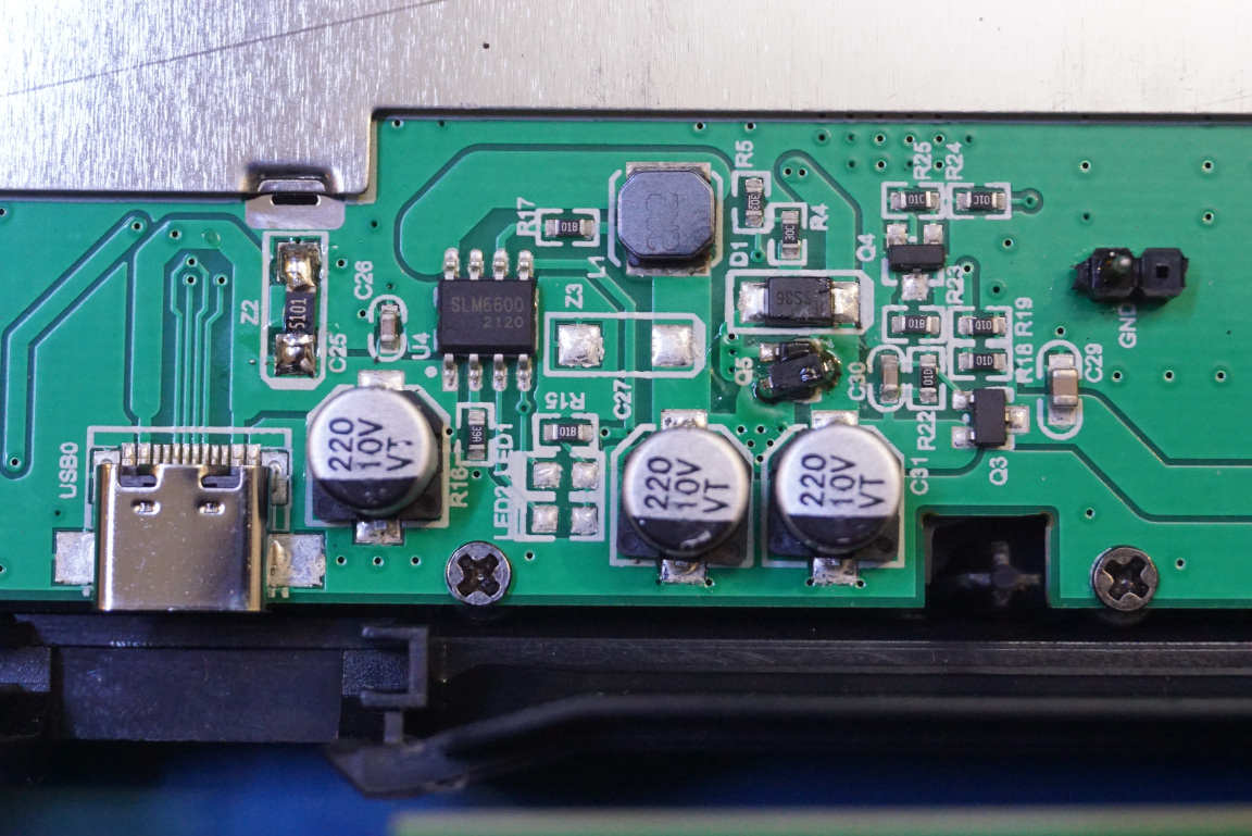

Below, you can see a couple of pictures of the front panel PCB. This PCB contains the display/keypad controls. There is likely a dedicated MCU on the other side as suggested by the programming header footprint. Interestingly enough, this board is also marked as ET202D as we saw on the main board. The picture to the right below shows the close-up of the battery charging circuitry. The charging controller is an SLM6600. If you look carefully, you can see there is a bodged on diode on Q5.
