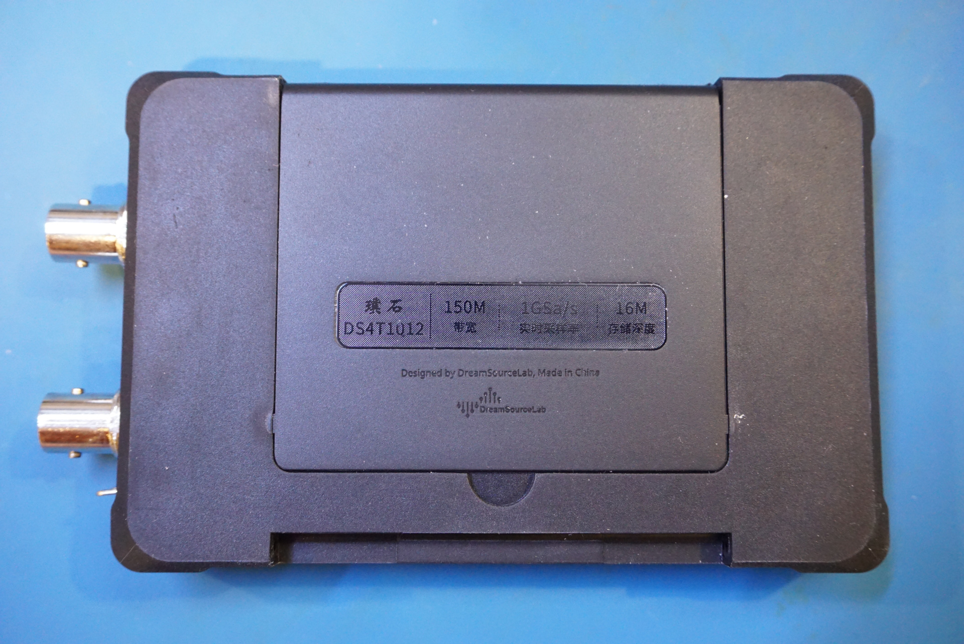

Here are a couple of pictures showing the front and the back side of the DS4T1012. There is an integrated stand on the back and it offers two tilting positions.

![](http://www.kerrywong.com/blog/wp-content/uploads/2023/09/back-1-1024x684.jpg)
