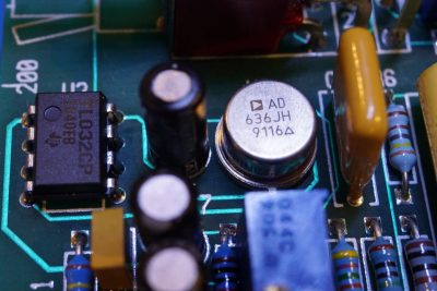

Below is a closeup of the AD636 and its surrounding circuitry. The “9116” date code suggests that this unit was made some time in the early 1990’s. Because this magnetometer has two additional outputs (RMS and wide-band), the second TL032 on the circuit board is probably used for bandpass filtering.

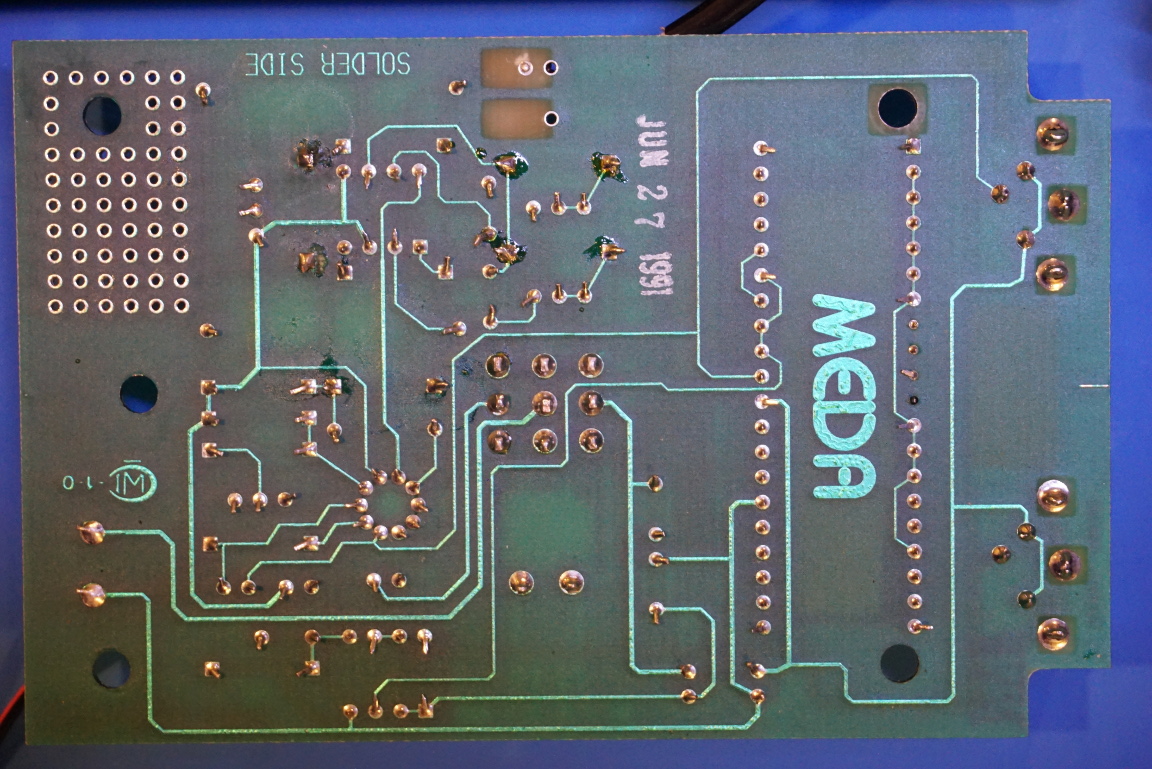

Here is a picture showing the reverse side of the board. It is pretty interesting that the board has a decorative prototyping area.

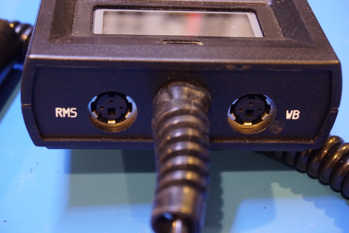

Here is a picture showing the DIN connectors for the RMS and wide band outputs.
